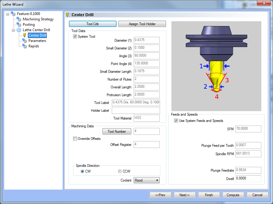

The Lathe Center Drill operation has only one tool type to choose from. It is good practice to have all the tools for the job loaded into the Tool Crib at the start of the job. By this point, those tools should already be in the Tool Crib, and the system will have pulled appropriate tools for each operation from the Tool Crib. From this tool page, you can either, choose a different tool from the Tool Crib, go into the Tool Crib to add tools from your Tool Library, or enter tool specific data manually into the Tool Data Section of the page.
Tool Data
To select a tool for the feature,you can use the following option in one of two ways.
  • System Tool
Select this check box to allow the software to automatically select tools from the Tool Cribthat match the machining operation. In the case of end mills, you may alter the diameter and corner radius allowing the software to find the appropriate tool from the Tool Crib. In the case the appropriate tool sizes are not found, the software searches for a matching tool in the Tool Library. If a matching tool is found, it is added to the Tool Crib. If a matching tool is not found, a new tool is automatically created and added to the Tool Crib.
When this check box is cleared, you can edit all tool information directly in the dialog box. In this case, the defined tool is added to the Tool Crib.
  • Diameter (1) - sets the diameter of the tool.
  • Small Diameter (2) - sets the small diameter of the tool.
  • Angle (3) - sets the angle of the area between the Small Diameter (2)  and the Diameter (1).
  • Point Angle (4) - sets the angle of the tip of the Center Drill.
  • Small Diameter Length - sets the length of the Small Diameter from end of Point Angle (4) to beginning of Angle (3).
Machining Data
  • Override Offsets
  • Offset Register  - sets the register on the machine that stores the height and diameter offset values for the tool.
Spindle Direction
    • CW - outputs the command for clockwise rotation of the spindle.
    • CCW - outputs the command for counter-clockwise rotation of the spindle.
Feeds and Speeds
  • Use System Feeds and Speeds
Clear this check box to type feeds and speeds values in the dialog box.
  • SFM/SMM - is the surface feet/meters per minute feedrate.
  • Feed per Tooth - is the feedrate for feed moves in units per tooth.
  • Plunge Feed per Tooth - is the feedrate for plunge moves in units per tooth.
  • Cutting Feedrate - is the feedrate for feed moves.
  • Plunge Feedrate - is the feedrate for plunge moves.
  • Arc Slowdown % - is the amount of the feedrate to use when in arc moves. 100% is equal to the Cutting Feedrate.
  • Dwell - sets the amount of seconds to Dwell.
Note: While editing the feeds and speeds, changing one value automatically calculates any other associated values. For example, if you modify the SFM value, the Spindle RPM, Cutting Feedrate, and Plunge Feedrate are automatically calculated.
Once the Rough Tool variables have been set, click Next >> to continue to the Parameters page.
