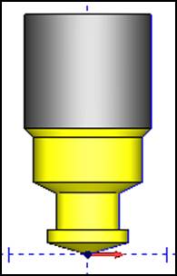

Custom Chain
Custom Tool
Custom Chain
Custom Tool
