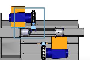

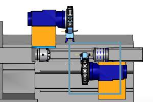

BC 2T 2S Mill Turn Machine
BC 2T 2S Submachine Naming
LT_MS = Lower Turret, Main Spindle
LT_SS = Lower Turret, Sub Spindle

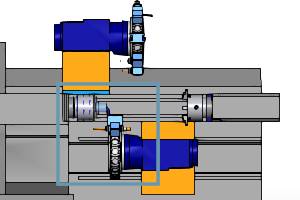

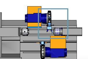

Machine Setups
For this tutorial, all features are created using one of two machine setups: one for the front side and one for the back side of the part. The following images show the location and orientation of the machining origin (work offset) for each setup.
Machine Setup 1
Machine Setup 2

The next three features that we create use the UT_MS (upper turret, main spindle) submachine, so we want to change the default submachine again. Changing the submachine this time is slightly different than the first time as features already exist, so we are prompted to confirm which features we want to change.
  1. Under Machine Setup - 1, right-click the current submachine name (LT_MS), and click Edit.
  1. Under Submachine Name, click the down arrow, and select UT_MS.
  1. Click OK to update the default submachine.
  1. A message displays to ask whether or not we want to change the submachine in existing features. We only want to change the default submachine for new features, so we click No.
All new machining features we create under Machine Setup - 1 now use the new submachine. The submachine can always be changed in the Posting page of the wizard.

Part 11) Change the Default Submachine for Machine Setup 2
Now that the part is transferred to the sub spindle, all of our machining features for the second half of the part are created under Machine Setup 2, which is set to Work Offset 2. Most of the remaining features use the UT_SS (upper turret, sub spindle) submachine, so we set the default submachine for creating features under Machine Setup 2.
  1. Expand Machine Setup - 2 (if needed), right-click the current submachine name UT_MS, and click Edit.
  1. Change the Submachine to UT_SS (upper turret, sub spindle), and click OK.

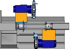

Part 16) Final Simulation
Important: For Mill Turn Jobs, you cannot post or simulate the program unless all tools are mounted in the Tool Crib. For example, when the software cannot find the appropriate tool in the Tool Crib during tool assignment, it assigns a tool from the Tool Library and places it under the Loose tools item in the device tree. Loose tools are tools that are assigned to an operation, but not mounted. All Loose tools must be mounted before simulating or posting. You can open the Tool Crib to confirm there are no unmounted (Loose) tools before simulating or posting the program.
  1. In the CAM Tree, right-click Mill Turn Tools, and click Tool Crib.
  1. In the device tree on the left, drag the slider down to view the Loose tools and confirm there are none. Note that there is one Loose tools item per device, so be sure to check both (all) devices for Loose tools.
Tip: BobCAD-CAM uses a special convention for Loose (unmounted) tools. The Tool Number for loose tools is -1 (negative one). When you see a tool with a tool number of -1, you know that you need to mount it (or assign a different tool to the corresponding operation). The easiest way to see where a loose tool is assigned is to open the Assigned Tools dialog box (right-click Mill Turn Tools, and click Verify Tool Assignment). This dialog box lists all features to which each tool is assigned.
  1. For our example, there are no loose tools, so we are ready to simulate the program.
  1. Right-click Mill Turn Job, and click Simulation.
ClosedView More Simulation Images
