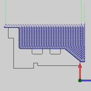

In this step we create a Lathe Turning feature, assign Rough and BasicFinish operations, and define the parameters of those operations.
  1. In the CAM Tree, right-click Machine Setup - 1 and selectLathe Turning.
  2. Click SelectGeometry.
    The Lathe Wizard hides and the Feature Geometry Picking dialog opens to allow geometry selection.
  3. In the graphics area the entire model as our geometry:
    1. Left-click
    2. Going to
    3. Click OK to confirm the geometry selection and return to the Lathe Wizard.
Tip: To confirm geometry selections, you can also click the icon in the toolbars or simply press Spacebar.
Left-click
Shift + Left-click
Result
  1. In the Lathe Wizard, click Next>>to continue to the Featurepage.
Adjust Feature Settings
  1. In order to avoid cutting the grooves with these operations, select the RemovePrimary Undercut check box in the Undercutgroup.
  2. To continue beyond the selected geometry,select the check box for Extensionand enter a value of 0.2500into the End Distance box.
  3. Click Next>>to continue to the Machining Strategypage.
Set the Machining Strategy
  1. Select Rough/ Finish in the Machining Strategy section of the Machining Strategy page to assign a Rough and BasicFinish operation to the feature.
  2. Select Parameters.
Adjust Parameters
  1. Adjust the Zvalue of the Finish Allowanceto 0.0010.
  2. In the Bounds group,select the Trimto Stock check box.
  4. Select Finish.
Tip: In this case, our stock has already been faced off. In order to avoid unnecessary feed movement, we use the Trim to Stock option to set trim the toolpath to the Operation Stock.
Select a ToolandCompute
  1. Click ToolCrib.
    The Tool Crib launches.
  2. Click FINISH and then click AddFrom Tool Library.
    The Tool Library launches.
  3. Select tool number 277to highlight the VNMG- 1/32RAD - FINISH TURNINGtool.
  4. Click OKto return to the Tool Crib.
  5. Click OKto return to the Lathe Wizard.
  6. Click Compute.
Blank Toolpath
  1. Right-click the new FeatureLathe Turning in the CAM Tree and select Blank/UnblankToolpath.

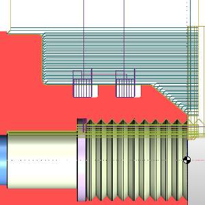

  1. Right-click Machine Setup - 1 in the CAM Tree and select LatheThread.
    The Lathe Wizard launches.
    In the graphics area:
    1. Select the entity to the right of the
    2. Drag a windowaround the entire groove. The groove and connected entities highlighted.
    3. Press confirm the geometry selection.
Set Feature Settings
  1. In the Feature page, under FeatureParameters select IDfrom the Feature Type list.
    1. In the StartDistance box enter a value of 0.3750.
    2. In the EndDistance box enter a value of 0.0300.
  3. Select Thread.
Select a Tool
  1. Click ToolCrib.
  3. Select tool number 505to highlight the 60 DEG - LAY DOWN - ID THREAD .IC  tool.
  4. click OK.
  5. In the Tool Crib:
    2. Click OK.
  6. Select Parameters.
Set Parameters and Compute
  1. Under Parameters,set Threads Per Unit to 5.0000.
  2. Select the check box for Overrideand set Thread Height to 0.1190.
Important: The ThreadHeight that is calculated in BobCAD-CAM is the theoretical sharp height. Depending on the thread being cut, you may need to adjust this value.
  1. Click Compute.
Blank Toolpath
  1. Right-click the new LatheThread feature in the CAM Tree and select Blank/UnblankToolpath.
