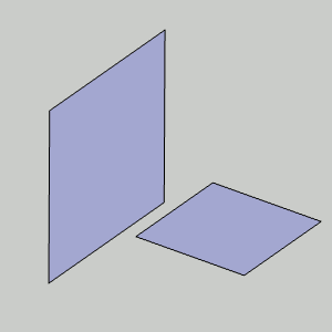

The Extend Surface function extends a surface along one edge at a time by the specified distance.Extend Surface supports Dynamic Drawing which allows you to modify the extension distance using sketch handles or data entry. The benefit of Dynamic Drawing is that you can use sketch handles when accuracy isn't needed and then use data entry when exact dimensions are needed.

Selected Geometry
Choose face to be extended
As soon as the edge to be extended is added to the Selected Geometry list, the possible faces to extended will be listed here to allow you to select which face is to be extended.
- Distance - sets how far the surface edge is extended.You can use data entry or the dynamic sketch handle to set this value. The snap increment applies when using the sketch handle.
