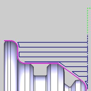

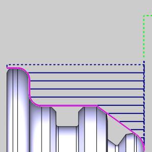

Standard - Each pass will be parallel to the center of rotation.

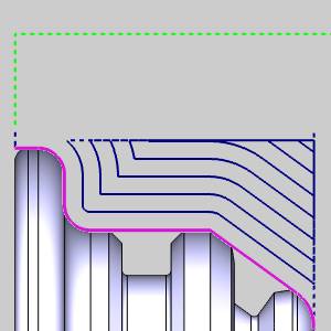

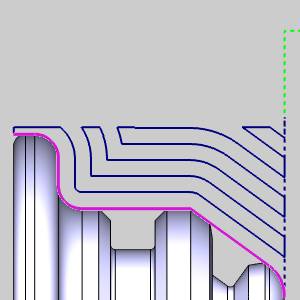

Offset - Each pass will be an offset copy of the selected geometry trimmed to the feature constraints.
Standard Offset

Standard - defines a one-way cutting pattern with retracts between each cut.
Zig Zag -  defines a two-way or alternating cutting pattern.
In the table below you can see how these sorting options affect the selected patterns.
Standard Pattern
With Standard Sorting
With Zig Zag Sorting
Offset Pattern
With Standard Sorting With Zig Zag Sorting
