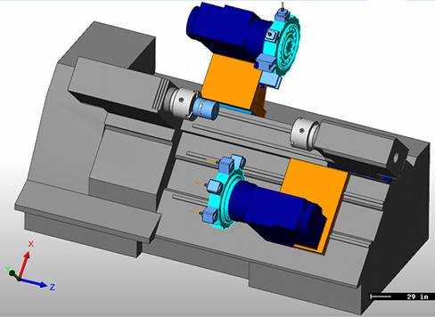

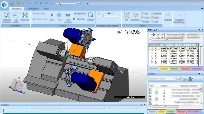

The simulation window is where you observe the machining process.
Tip: This simulation can be launched as its own independent window by selecting Separate Window for the Simulation Window option in the System > CAM > Simulation group of the Settings dialog.
The Ribbon Bar
The ribbon bar tabs at the top of the simulation window provide the commands needed to run (play) the simulation as well as defining the view orientation and status of all elements in the simulation window (such as the workpiece, fixture, stock, tool, machine, and toolpath).

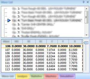

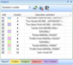

The Analysis and Information tabs that display on the right side of the simulation window are used to access the many extremely powerful simulation tools, such as the Toolpath Analysis, Stock Analysis, the Move List, and many others.

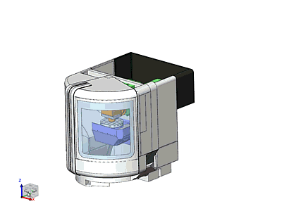

The Machine Model (Machine Simulation Pro)
For customers that have purchased the full machine simulation, you can add geometry (.stl) files to define all of the machine elements that display in the simulation window. This is extremely beneficial, for example, for multiaxis customers that need to confirm that all machine movements during the program are collision free.
