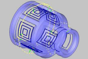

Wrapped Geometry
The Wrapped Geometry check box determines whether the geometry that you assign to features in the wrapping group is drawn unwrapped (flat) or is selected directly from wrapped (cylindrical) geometry. Note that if you change this option after creating features, you must change the geometry selection and compute the feature to update the toolpath for the existing operations to use the new setting.
Select the Wrapped Geometry check box when you want to select wrapped or cylindrical geometry.
Clear the Wrapped Geometry check box when you want to select unwrapped or flat geometry.

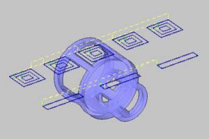

When creating features under a wrapping group, you can select either wrapped or unwrapped geometry. The drawing plane for unwrapped geometry is determined by the job type.
Unwrapped Geometry for Mill Jobs
When selecting unwrapped geometry for Mill jobs, the geometry must be on the XY plane of the machining origin (machine setup) coordinate system defined for the feature.
Unwrapped Geometry for Mill Turn Jobs
When selecting unwrapped geometry for Mill Turn jobs, the geometry must be on the YZ plane of the machining origin (machine setup) coordinate system defined for the feature.
