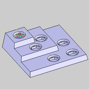

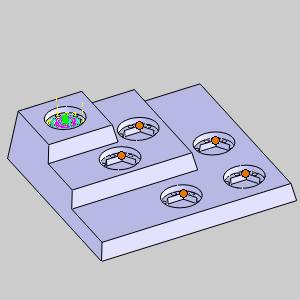

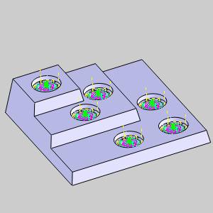

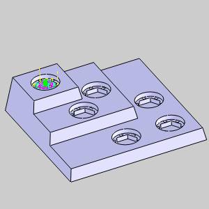

Specified Points
This options allows you to handle situations that do not fall neatly into the a simple translation pattern. Pick the Start point, then pick the positions where the copies should be created.
Toolpath to be patterned
Start Point
Positions
Result
