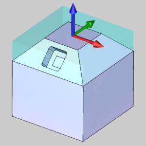

The Index System defines the rotary angles used for 4- or 5-axis indexing. You add an Index System to define each plane of the part that is machined. To define the plane, you can select a surface or a UCS (user coordinate system). Milling Features can then be created for each Index System. When you use Index Systems, the complete program (including the indexing of the part) can be viewed in simulation.

Important: When you select a surface or plane to set the index location, the surface or plane becomes the Z-axis zero for setting the feature parameters.
