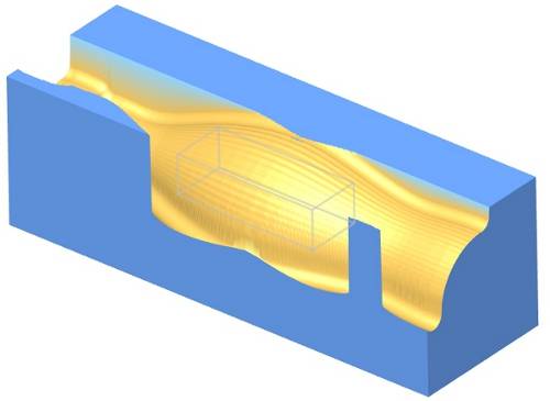

Refine Box
Use the Refine Box to zoom into a certain area of the stock model. The material around the Refine Box is removed, thus using the full resolution for the zoomed area.
Available Controls
(Apply Refine) - will attempt to improve the resolution of the current view. When a Refine Box has been defined, this control will remove the material outside of the Refine Box and attempt to improve the resolution of the area that box has defined.
(Reset Refine) - will reset the material to its original state.
Move the cursor onto the stock. Then click the middle mouse button to select the start point, end point, and a point for depth. Use additional clicks of the middle mouse button to further refine the size of the box.
Once the box is the desired size, click (Apply Refine) to apply. This process can be repeated again on the refined area.
Click (Reset Refine) to get to the original state.
