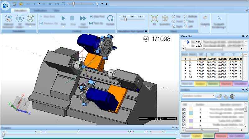

The Simulation Window
The simulation window is where you observe the machining process.
The Ribbon Bar
The ribbon bar tabs at the top of the simulation window provide the commands needed to run (play) the simulation as well as defining the view orientation and status of all elements in the simulation window (such as the workpiece, fixture, stock, tool, machine, and toolpath).

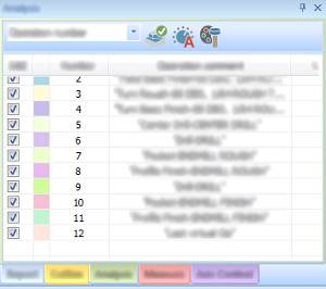

Analysis and Information Tabs
The Analysis and Information tabs that display on the right side of the simulation window are used to access the many extremely powerful simulation tools, such as the Toolpath Analysis, Stock Analysis, the Move List, and many others.

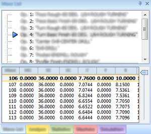

Move List

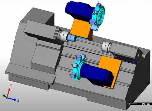

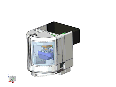

The Machine Model (Machine Simulation Pro)
For customers that have purchased the full machine simulation, you can add geometry (.stl) files to define all of the machine elements that display in the simulation window. This is extremely beneficial, for example, for multiaxis customers that need to confirm that all machine movements during the program are collision free.
To learn about defining your machine, view the Current Settings Default and How to Create a Machine.
