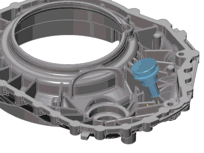

The Simulation tab contains many of the most used buttons for controlling the simulation. This tab contains the Simulation, Control, Simulation Run Speed, Views, Visibility, and Toolpath Rendering groups. The available buttons for each group are explained next. When hovering over some of these options, you will notice a letter in parentheses. This letter is the available shortcut key to access this item without needing to click on it directly.
Simulation
Backplot or Material Removal Mode
The simulation can be run in one of two modes for material removal or toolpath backplot only.
Toolpath Backplot Mode(B) - simulates the toolpath only without material removal (the stock button becomes unavailable as well as many of the material removal verification tools).
Material Removal Mode(V) - simulates the toolpath including material removal. Many of the features of the simulation are designed to work with this mode to verify the material removal.
