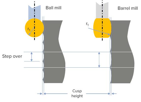

Barrel Mills are designed to be able to take a larger depth of cut, while maintaining the desired cusp height.

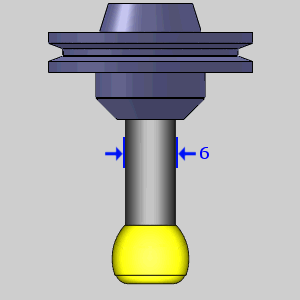

Flute Height by
The Flute Height by parameter gives you the option to define the height of the flutes by either the upper diameter, or the flute length. In the table below, you will see each choice, the parameter it presents, and an image of that parameter.
Upper Diameter Length
Shaft Diameter (6) Flute Length (2)

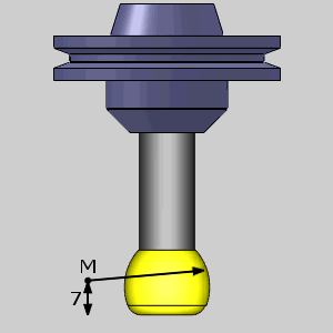

Profile Position by (Axial)

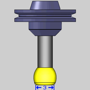

The most prominent aspect of the tool is its main radius (M), and the position of that radius. This is referred to as the Profile Position, and requires two parameters to define it properly.  The first is the Axial definition. The axial definition can be defined with either Distance(M), which is the height of the arc center from the tool tip, or with the Reference Diameter, which is what the diameter at the tool tip would be if there were no corner radius. In the table below, you will see each choice, the parameter it presents, and an image of that parameter.
Distance(M) Reference Diameter
Distance(M) (7) Diameter (3)

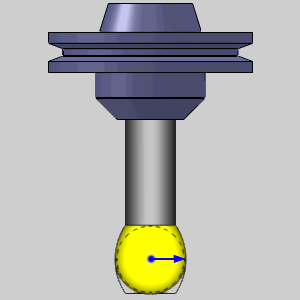

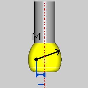

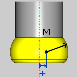

Profile Position by (Radial)

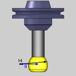

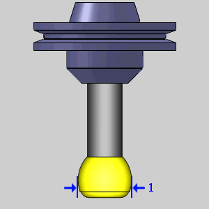

The second definition needed to describe the main radius of the tool (M), and its position, is the Profile Position by (Radial). This can be defined by either the Distance(M), or the Max Diameter. The Distance(M) describes the distance from the center of the main radius to the center of the tool. The Max Diameter describes the full diameter of the tool itself, and not necessarily the radius (M) of the profile. In the table below, you will see each choice, the parameter it presents, and an image of that parameter.
Distance(M) Max Diameter
Distance (M) (8) Diameter (1)
Important: Distance(M) (8): This value will typically be negative, unless the arc and its center are on the same side of the revolved axis as seen in the images below.
Distance(M) Distance(M)
Negative Value Positive Value

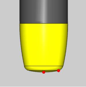

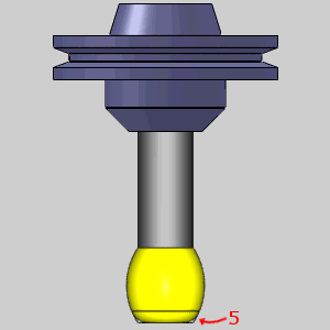

Corner Radius Type
There are three options when it comes to the corner radius of the tool. You can choose between either None, Corner, or Full. When None is chosen there is no parameter added and no corner radius is added. When Corner is chosen the Corner Radius (5) is added to allow you to enter the specify radius to use. When Full is chosen there is no parameter added, no additional parameter is added, but the tool will utilize the widest point of the radius from the center of the tool to round the bottom as shown in the image below. In the table below, you will see each choice, the parameter it presents, and an image of that parameter.
None Corner Full
(No additional value is added to the definition) Corner Radius (5) (No additional value is added to the definition)

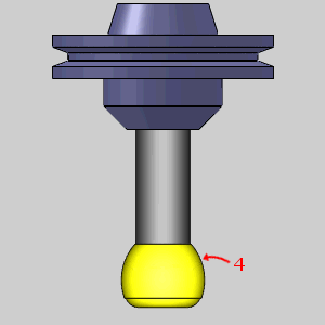

Profile Radius (4)
Regardless of the options you use to define the tool shape, each and every tool will allow you to enter the Profile Radius (4). This is the main radius of the tool.
Profile Radius (4)

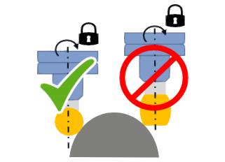

Where not to use Barrel Tools
While barrel tools are a huge help in many circumstances, their strength can also be their weakness:
Concave radii smaller than the barrel radius Convex shape orthogonal to feed direction If you are unable to perform the described tilting

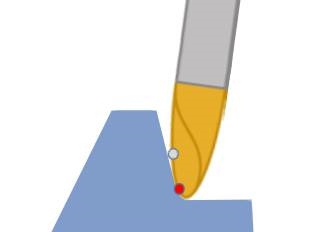

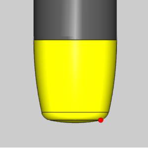

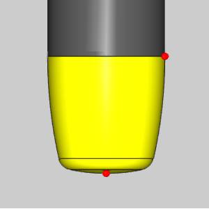

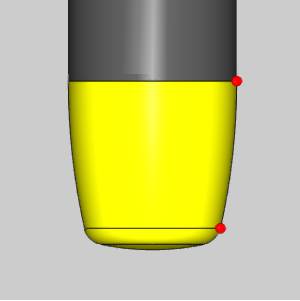

Using the Contact Point

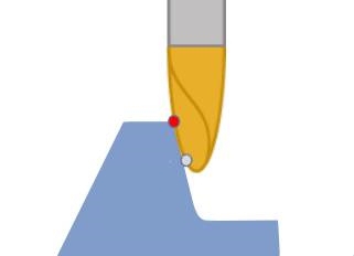

In the Tool axis control page, you can set Tool axis will ... to Be tilted relative to cutting direction. You will then have the option to Set side tilt by. This tilt of the tool can then be defined by either:
Angle Contact point

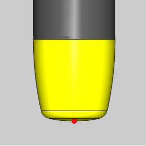

Choosing the Contact point option then allows you to specify how that contact point is defined with the Contact point definition parameter. You can place this contact point on the tool by defining either:

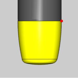

By height By line parameter
The values used for the contact point are between 0 and 1 which represent 0% to 100% of the flute height, or along the profile line.
0.0 0.5 1.0
When using the By line parameter option, you can also define the Considered profile section by either:
Note: While the Full profile is active for all tools, the Barrel section is available only for Barrel Mill tool types. The Convex tip section option is only available for the Double Profile, and Lens barrel types.
Full Profile 0.0 1.0
Barrel section 0.0 1.0
Convex tip section 0.0 1.0
By utilizing the contact point, and setting a To value, you can force the tool to begin the toolpath at one contact point, and end at another:
Start Value End Value
