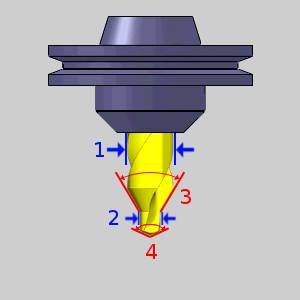

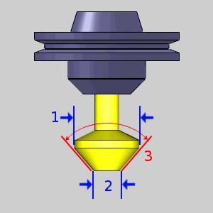

Drill
ClosedCenter Drill
Tool Parameters
  • Tool Label - allows you to set, or modify, a tool name.
  • Diameter (1) - sets the diameter of the tool.
  • Sm. Dia. (2)- sets the small diameter of the tool.
  • Angle (3) - sets the angle of the area between the Small Diameter (2)  and the Diameter (1).
  • Point Angle (4) - sets the angle of the tip of the Center Drill.
  • Sm.Dia.Len. - sets the length of the Small Diameter from end of Point Angle (4) to beginning of Angle (3).
  • Tool Number - sets the number to be used in tool callout unless otherwise specified.

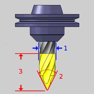

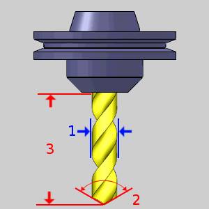

ClosedDrill
Tool Parameters
  • Point Angle (2) - sets the angle of the tip of the Center Drill.
  • Flute Length (3) - sets the length of the flute/cutting portion of the tool.
  • Num Flutes - specifies the number of cutting flutes for the tool.

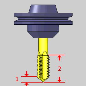

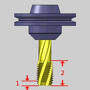

ClosedSpiral Tap
Tool Parameters
  • Thread-  displays the thread type and size. Click the button to launch the Thread Type dialog to allow you to change the Thread Type and Thread Size.
  • Inef. Num of Thread (1) - sets the ineffective length for tap tools using the number of threads.
  • Thread Direction - Select Right Hand or Left Hand to determine which direction the thread is tightened in.

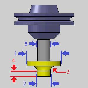

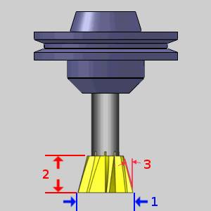

ClosedChamfer Tool
Tool Parameters
  • Sm. Dia. (2) - sets the small diameter of the tool.
  • Inef. Length - specifies the length of extension on the small diameter that is not used for cutting.

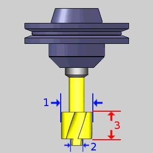

ClosedCounterbore
Tool Parameters

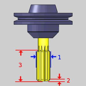

ClosedReamer
Tool Parameters
  • Ineffective Length (2) - sets the length of the chamfer on the tip of the tool.

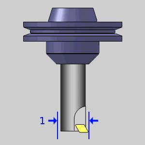

ClosedBoring
Tool Parameters

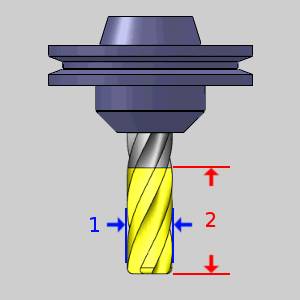

ClosedEndmill Rough
Tool Parameters
  • FluteLength (3) - sets the length of the flute/cutting portion of the tool.
  • Corner Radius - sets the size of the radius on the corner of the endmill.
  • OverallLength - set the total length of the tool.This valuemust be greater than the Protrusion Length.
  • ProtrusionLength - sets the distance that the tool protrudes from the tool arbor when a tool holder is assigned to the tool.
  • ToolMaterial - is the tool material type of the selected tool.

ClosedChamfer Mill
Tool Parameters
  • Angle (2) - sets the angle of the area between the Small Diameter (3)  and the Diameter (1).
  • Sm. Dia. (3)- sets the small diameter of the tool.
Tool Holder
  • Assign/Remove Tool Holder - When no tool holder has been assigned, the Holder Label will be blank, and the button will read: Assign Tool Holder. This will open The Milling Tool Holder Library to allow you to select, or create a tool holder to associate with the selected tool. Once a tool holder has been assigned, the button will read: Remove Tool Holder. This will remove the association between the tool holder and the selected tool.
Feeds and Speeds
  • Use System Feeds and Speeds
    Clear this check box to type feeds and speeds values manually.
  • Spindle Speed/RPM - is the revolutions per minute of the spindle.
  • Plunge Feedrate - is the downward feedrate. This value is linked to the Plunge Feed per Tooth.
Custom Geometry
  • Assign Tool Geometry - hides the Tool Library and opens the Tool Shape Picking dialog to allow you to select geometry from the graphics area to assign as the shape of the tool. You can learn more about assigning custom tools in the Assigning Custom Tools topic.
ClosedCorner-Round
When defining a corner rounding tool, the diameter must be greater than or equal to the small diameter plus twice the corner radius.
Diameter >= Small Diameter + (Corner Radius * 2)
If you enter values that do not fit this equation, an error message displays.
Tip: When defining a corner rounding tool, if the Diameter is greater than the current/default value, set the Diameter value first. This allows you to avoid receiving the error message. If the Diameter is less than the current/default value, set the Corner Radius first to avoid the error message.

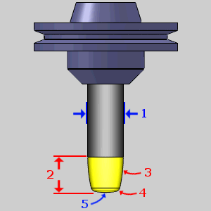

Tool Parameters
  • Corner Radius (3) - sets the size of the radius on the corner of the endmill.
  • Sm.Dia.Len. (4) - sets the length of the Small Diameter from end of the Corner Radius (3) to beginning of Small Diameter (2).
  • Shaft Diameter (5) - sets the diameter of the shaft.
Tool Holder
Feeds and Speeds
Custom Geometry
ClosedThread Mill

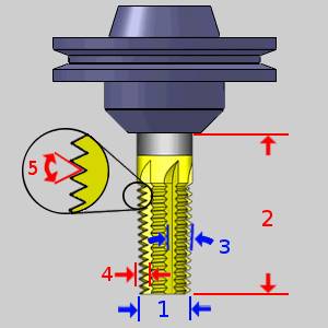

Tool Parameters
  • Flute Length - sets the length of the flute/cutting portion of the tool.
  • Protrusion Length (2) - sets the distance that the tool protrudes from the tool arbor when a tool holder is assigned to the tool.
  • Taper Angle (3) - sets the angle of the taper.
  • Pitch - sets the distance from one tooth to the next.
  • Thread Height (4) - is the major diameter, minus the minor diameter, divided by two.
  • Thread Angle (5) - sets the included angle between the thread flanks.
Tool Holder
Feeds and Speeds
  • Cutting Feedrate - is the feedrate for feed moves.
Custom Geometry

ClosedV-Tool
Tool Parameters
  • Included Angle (2) - sets the angle of the tool tip.
  • Flat End Diameter - sets the diameter of the flat portion at the tip of the tool.
Tool Holder
Feeds and Speeds
Custom Geometry

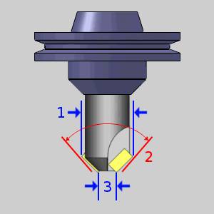

ClosedTapered
Tool Parameters

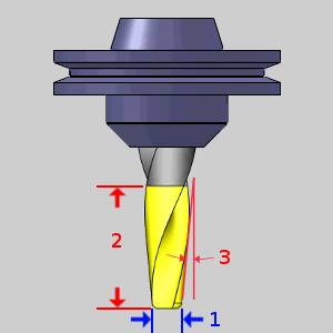

  • Angle (3) - sets the angle of the taper.
Tool Holder
Feeds and Speeds
Custom Geometry

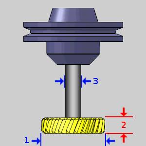

ClosedT-Cutter
Tool Parameters
Tool Holder
Feeds and Speeds
Custom Geometry
ClosedDove Mill
Tool Parameters
Tool Holder
Feeds and Speeds
Custom Geometry

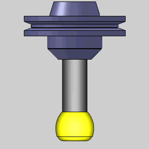

ClosedLollipop
Tool Parameters

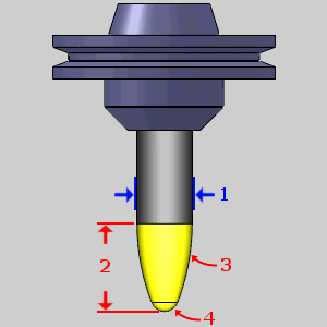

  • Shaft Diameter (3) - sets the diameter of the shaft.
Tool Holder
Feeds and Speeds
Custom Geometry

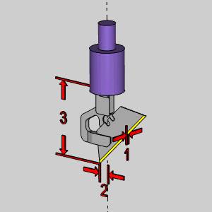

ClosedDrag Knife
Tool Parameters
  • Blade Thickness (1) - sets the width of the blade.
  • Blade Offset (2) - sets the distance between the tools center of rotation and the tip of the blade.
  • Protrusion Length (3) - sets the distance that the tool protrudes from the tool arbor when a tool holder is assigned to the tool.
Tool Holder
Feeds and Speeds

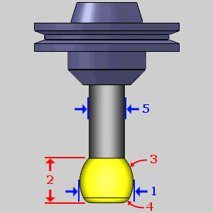

Tool Parameters
  • Profile Radius (3) - sets the main radius of the tool.
  • Corner Radius (4) - sets the size of the radius on the corner of the tool.

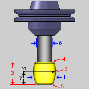

Tool Parameters
  • Flute Height by:
    • Upper Diameter - Shaft Diameter (6)
    • Length - Flute Length (2)
  • Profile Position by (Axial):
    • Distance(M) - Distance(M) (7)
    • Reference Diameter - Diameter (3)
  • Profile Position by (Radial):
    • Distance(M) - Distance(M) (8)
    • Max Diameter - Diameter (1)
  • Corner Radius:
    • None - (No additional value is added to the definition)
    • Corner - Corner Radius (5)
    • Full - (No additional value is added to the definition)
  • Diameter (1) - sets the total diameter of the widest potion of the flute.
  • Diameter (3) - sets the end diameter at the tool tip. This parameter is to be calculated as if there were no corner radius.
  • Profile Radius (4) - sets the main radius of the tool.
  • Corner Radius (5) - sets the small radius used at the corner of the tool tip.
  • Shaft Diameter (6) - sets the diameter of the shaft.
  • Distance(M) Axial (7) - sets the position of the main radius by defining the height of its center as referenced from the tool tip.
  • Distance(M) Radial (8) - sets the position of the main radius by defining the distance of its center from the center of the tool.

ClosedBarrel-Tangent
Note: To get a more in depth look at the barrel tool type, see the Barrel Mills topic.
Tool Parameters
  • Corner Radius (4) - sets the small radius used at the corner of the tool tip.

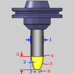

ClosedBarrel-Taper
Tool Parameters
  • Taper Angle (2) - sets the angle of the tools taper.
  • Flute Length (3) - sets the length of the cutting portion of the tool.
  • Upper Radius (4) - sets the radius used between the taper and the shaft of the tool.
  • Profile Radius (5) - sets the main radius used on the taper portion of the tool.
  • Corner Radius (6) - sets the diameter of the shaft.
  • Flatness Diameter (7) - sets the width of the flat portion on the tool tip.
  • Lower Radius (5) - sets the radius used on the tool tip.
  • Upper Corner Radius (4) - sets the radius used at the upper corner of the Profile Radius.
  • Lower Corner Radius (5) - sets the radius used at the lower corner of the Profile Radius.
