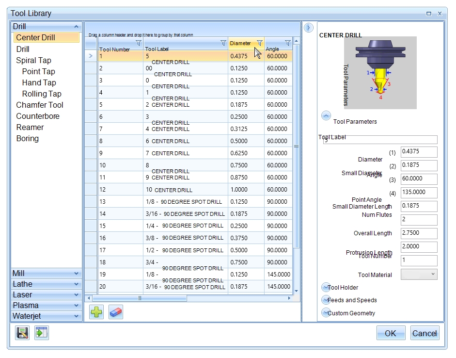

Tool Library Interface

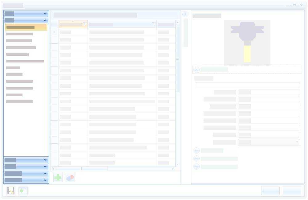

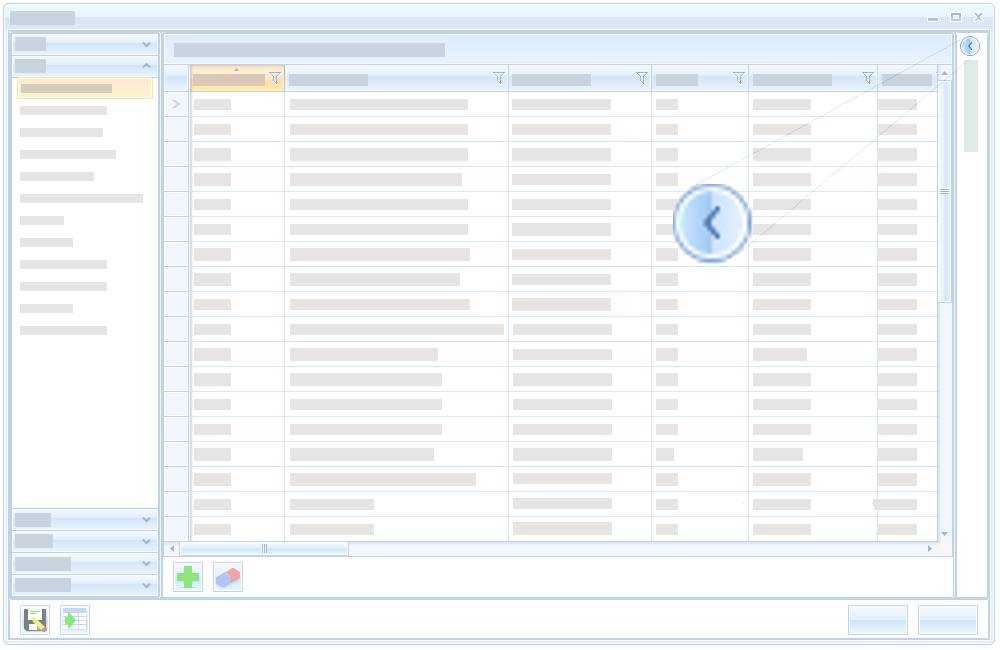

Tool Panel Bar
The left-most portion of the Tool Library is the Tool Panel Bar which groups the tools. The tool are divided first by Drill, Mill, Lathe, Laser, Plasma, and Waterjet. Clicking on a particular group will display the available tool types in that group. Finally, clicking on a particular tool type will show all the tools available tools of that type.
Tool Grid View
With a particular tool type selected, the Tool Grid View will show all the available tools of that type. From this point you can add tools, or highlight a particular tool to delete it.

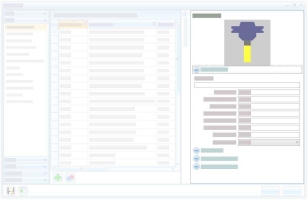

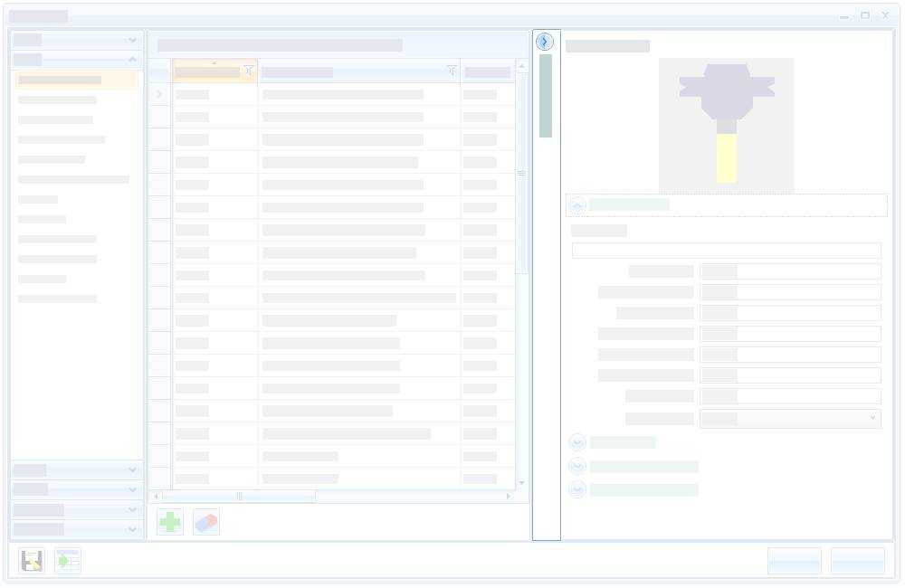

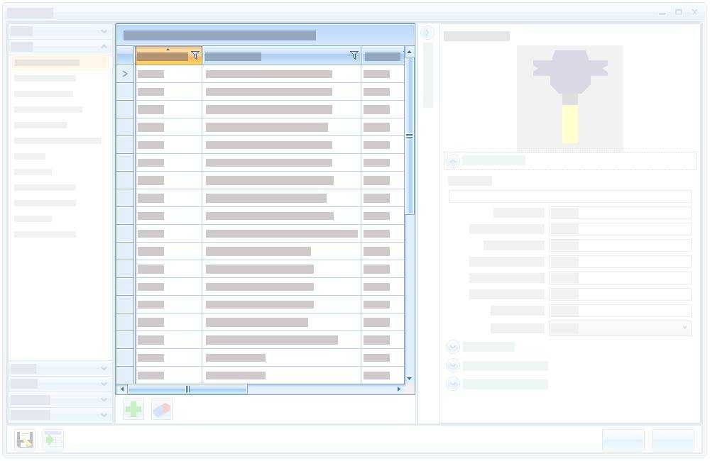

Tool Parameter Grid Splitter
Upon opening the Tool Library, the Tool Parameter Dialog will be collapsed. To expand the Tool Parameter Dialog, click the chevron icon. With the Tool Parameter Dialog expanded, click the chevron icon to collapse it. The Tool Parameter Grid Splitter can also be used to resize the Tool Parameter Dialog. Hover over the left side of the Tool Parameter Grid Splitter until the mouse icon displays as the double headed arrow. You can then hold left-click and drag the dialog to the desired size.

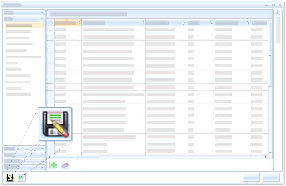

Saving the Library
Libraries can be saved in order to share the library between work stations, or can be saved to move your library from an older version of BobCAM to a newer version.
To save your tool library:
  1. Click the Save As button on the bottom left.
    The Save As dialog appears.
  2. Choose a name and a location for the file.
  3. Click Save.
    The file is saved.

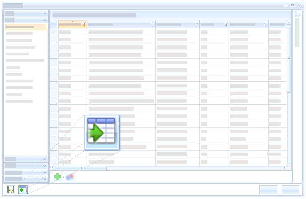

Importing a Library
To use an existing library:
  1. Click the Import from file button on the bottom left.
    The Open dialog appears.
  2. Locate and highlight the appropriate file.
  3. Click Open.
    The library is updated based on the imported file.

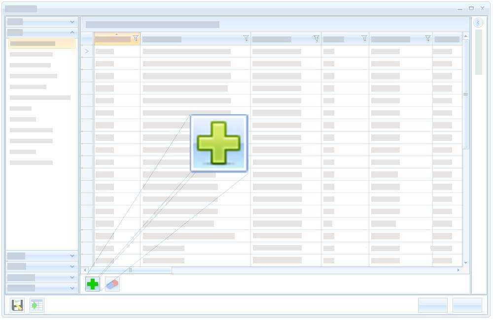

Adding a Tool
  1. Click the Add button at the bottom left of the tool list.
    This tool is now in the Tool Parameter Dialog to allow for editing.
Editing a Tool
  1. Click the chevron next to the Tool Parameter Dialog to automatically expand it.
    You can also do this manually by hovering over the right side of the Tool Grid View and dragging it into position once the double headed arrow icon appears.
  2. Edit the desired Tool Parameters.
  3. Select another tool in the Tool Grid View to update the edited tool data in the Tool Grid View, and to select another tool to edit.
  4. Repeat steps 2 & 3 as needed.
  5. With all tools edited as needed, click OK.

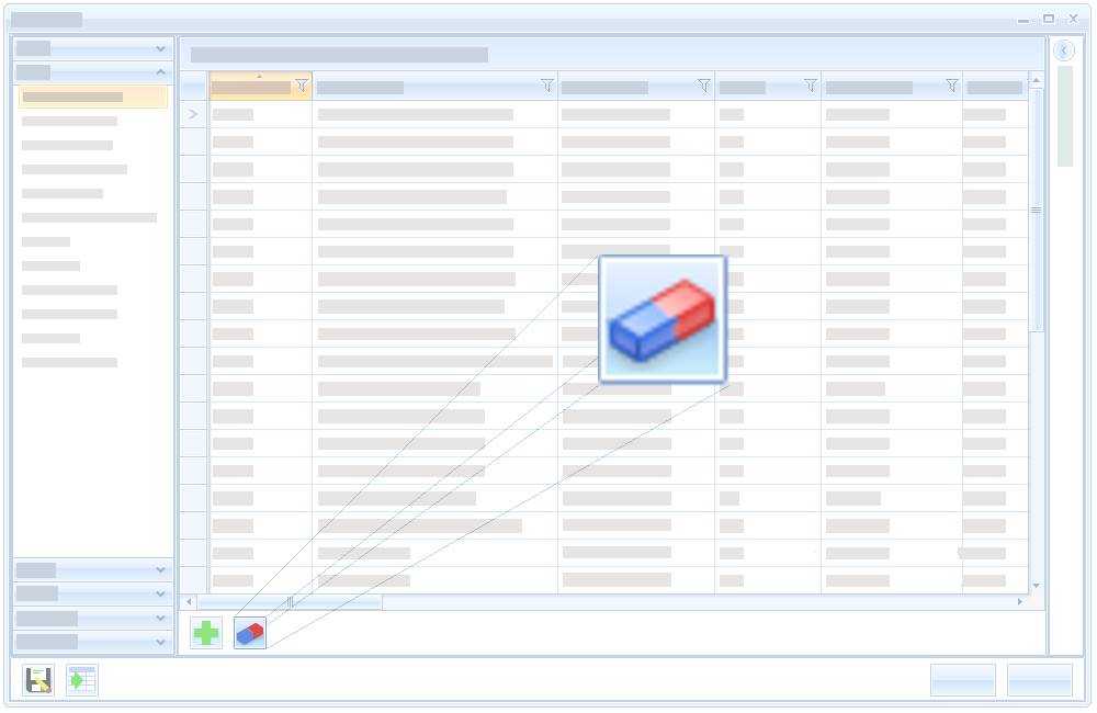

Deleting a Tool
  1. Highlight the desired tool.
  2. Click the Delete icon.
    A message box appears asking: Are you sure you want to delete this tool?
  3. Click Yes.

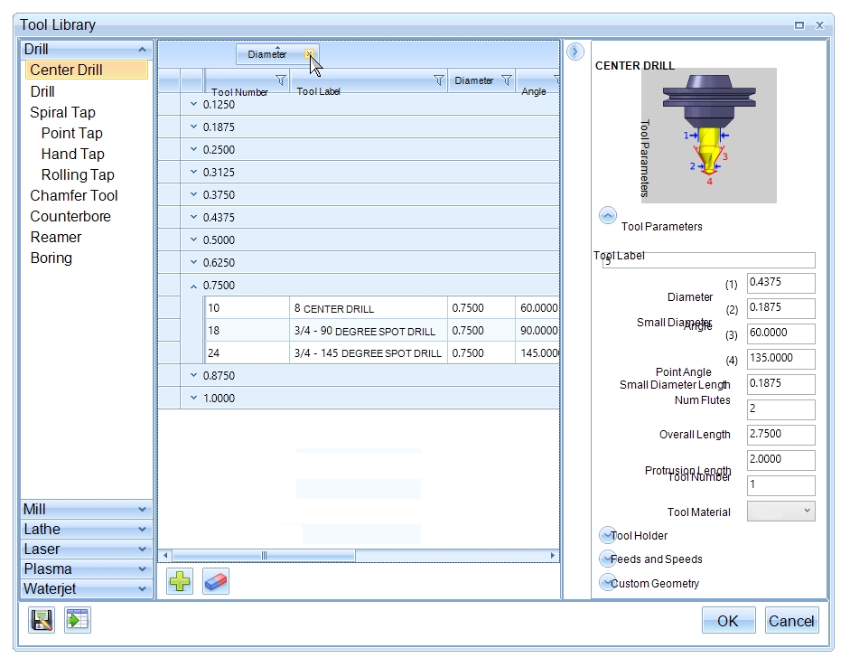

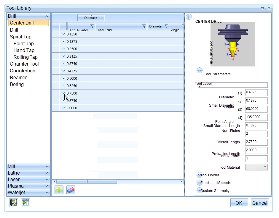

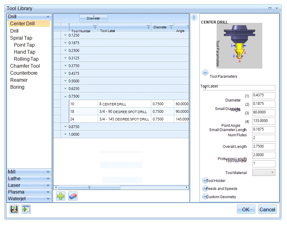

Grouping by Column
  1. Highlight the header you would like to use to group your tools.
  2. Click and hold the left mouse button while you drag the header into the area just above.
  3. Release the mouse to group by that column.
    All rows are not grouped by that header and collapsed.
  4. To expand a particular row, click the arrow as seen in the images below.
  5. To undo the grouping, hover over the header you dragged into the grouping area.
    Notice the close button that appears on the header.
  6. Click the close button to remove the grouping.

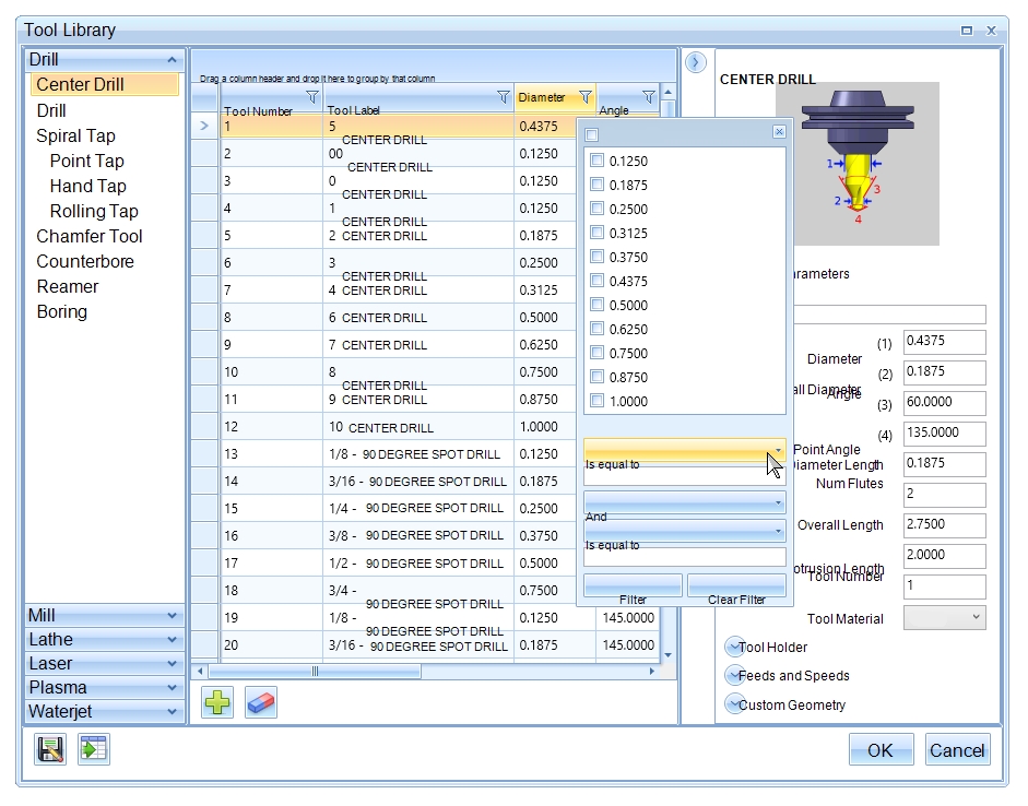

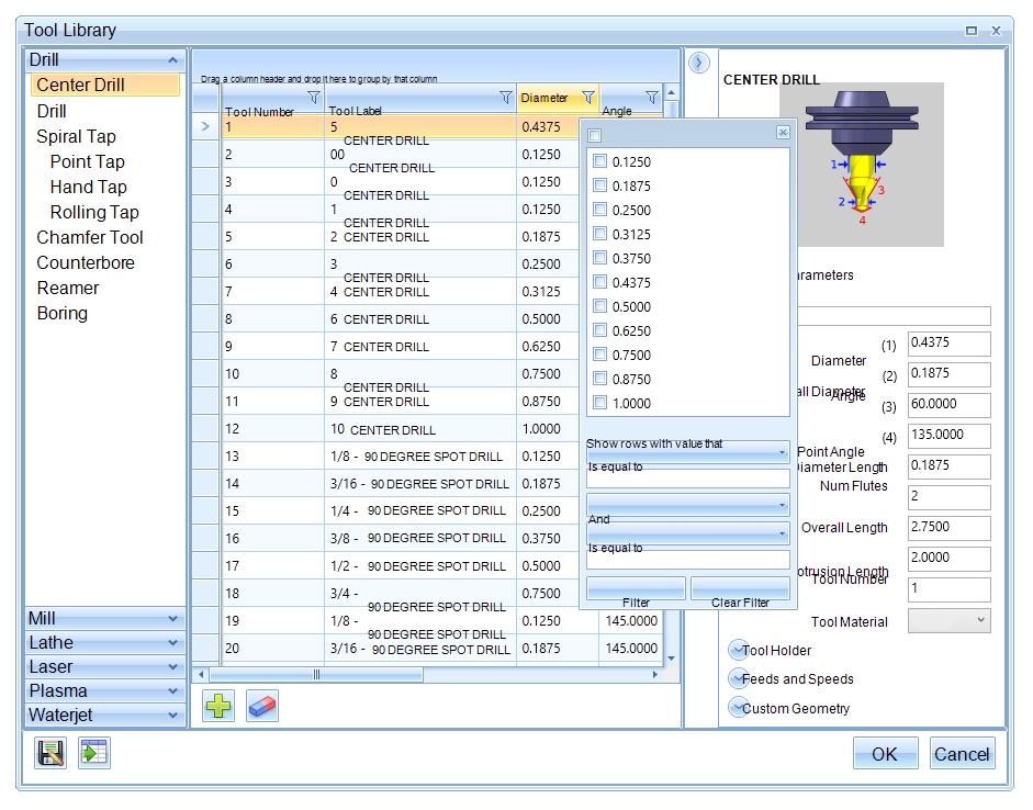

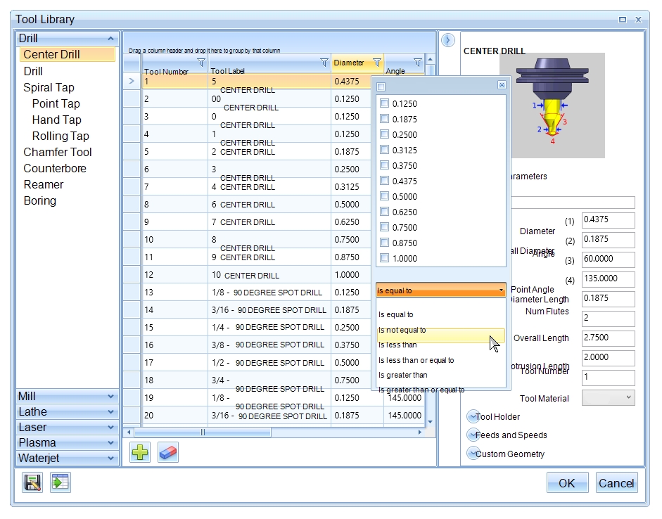

Filtering by Columns
The column information can be used to filter which tools appear in the list. Clicking the icon on a header opens the filter dialog which then lets you set select which rows to show, based on the rows you select, or the conditions you set. The available conditions can be seen in the table below:
Show rows with value that
  • Is equal to
  • Is not equal to
  • Starts with
  • Ends with
  • Contains
  • Does not contain
  • Is contained in
  • Is not contained in
  • Is empty
  • Is not empty
  • Is less than
  • Is less than or equal to
  • Is greater than
  • Is greater than or equal to
  • Is null
  • Is not null
  • And
  • Or
  • Is equal to
  • Is not equal to
  • Starts with
  • Ends with
  • Contains
  • Does not contain
  • Is contained in
  • Is empty
  • Is not empty
  • Is less than
  • Is greater than
  • Is null
  • Is not null
  1. Hover over the filter icon in the desired header.
    The hand icon appears.
  2. Click on the filter icon.
    The filter dialog appears.
  1. Click the first drop down.
  2. Set the condition to Is less than.
    With the value set, the drop down collapses.
  3. Under the first drop down, click in the text field and enter 0.750, and press Enter.
    The tool list updates.
  4. Leave the second drop down set to And.
  5. Set the third drop down to Is greater than.
  6. Under the third drop down, click in the text field and enter 0.250, and press Enter.
Note: Columns that allow for text, like the Tool Label column have the addition of the toggle next to the text field. This will allow you to specify whether capitalization matters in your filter. To test this, filter the Tool Label column and set the first condition to Contains and type spot in lowercase. Then turn the toggle on and off. When the toggle is on, no tool labels containing an uppercase "spot" can be found. When the toggle is off, several tool labels containing the word "spot" can be found.
