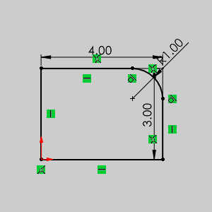

Part 2) Create the Rectangle
- Right-click the Front Plane and select Sketch.
- Choose Tools > Sketch Entities > Corner Rectangle.
- Starting at the origin, create a rectangle with values X = 4 and Y = 3 and click OK.

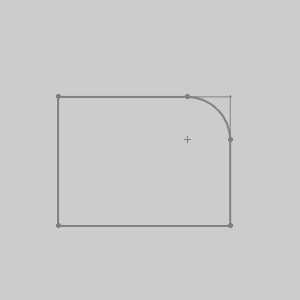

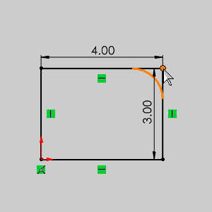

Part 3) Create the Fillet
- Choose Tools > Sketch Tools > Fillet...
- Set the Parameters to 1.0000.
- Select the Vertex at the top-right and click OK.
- Exit the sketch.

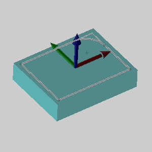

Part 6) Set the Machine Setup and Work Offset
- Select the following vertex as the origin.
- In the Work Offset group, set the Z value to .000.
- Click OK.

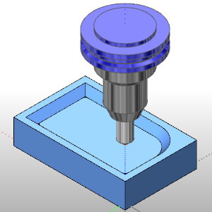

Part 8) Set the Roughing Tool
- Click Next >> again to move to the tool page.
- Change the Diameter
value to , and press
Tab to update the value.
The system automatically selects a tool from the Tool Library (after checking the Tool Crib).

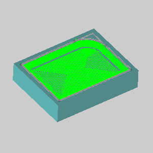

- At the bottom of the wizard, click Compute.
- To view the toolpath simulation, right-click Milling
Job and click Simulation.
