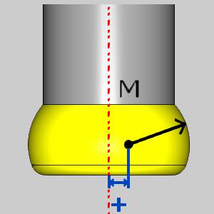

The second definition needed to describe the main radius of the tool (M), and its position, is the Profile Position by (Radial). This can be defined by either the Distance(M), or the Max Diameter. The Distance(M) describes the distance from the center of the main radius to the center of the tool. The Max Diameter describes the full diameter of the tool itself, and not necessarily the radius (M) of the profile. In the table below, you will see each choice, the parameter it presents, and an image of that parameter.
| Distance(M) | Max Diameter |
| Distance (M) (8) | Diameter (1) |
Important: Distance(M) (8): This value will typically be negative, unless the arc and its center are on the same side of the revolved axis as seen in the images below.
| Distance(M) | Distance(M) |
| Negative Value | Positive Value |
