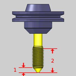

ClosedSpiral Tap
Tool Parameters
  • Thread-  displays the thread type and size. Click the button to launch the Thread Type dialog to allow you to change the Thread Type and Thread Size.
  • Inef. Num of Thread (1) - sets the ineffective length for tap tools using the number of threads.
  • Thread Direction - Select Right Hand or Left Hand to determine which direction the thread is tightened in.
  • Tool Number - sets the number to be used in tool callout unless otherwise specified.
Tool Holder
  • Assign/Remove Tool Holder - When no tool holder has been assigned, the Holder Label will be blank, and the button will read: Assign Tool Holder. This will open The Milling Tool Holder Library to allow you to select, or create a tool holder to associate with the selected tool. Once a tool holder has been assigned, the button will read: Remove Tool Holder. This will remove the association between the tool holder and the selected tool.
Feeds and Speeds
  • Use System Feeds and Speeds
    Clear this check box to type feeds and speeds values manually.
  • Spindle Speed/RPM - is the revolutions per minute of the spindle.
Custom Geometry
  • Assign Tool Geometry - hides the Tool Library and opens the Tool Shape Picking dialog to allow you to select geometry from the graphics area to assign as the shape of the tool. You can learn more about assigning custom tools in the Assigning Custom Tools topic.

ClosedThread Mill
Tool Parameters
  • Diameter (1)- sets the diameter of the tool. tool.
  • Flute Length - sets the length of the flute/cutting portion of the tool.
  • Num Flutes - specifies the number of cutting flutes for the tool.
  • Protrusion Length (2) - sets the distance that the tool protrudes from the tool arbor when a tool holder is assigned to the tool.
  • Taper Angle (3) - sets the angle of the taper.
  • Pitch - sets the distance from one tooth to the next.
  • Thread Height (4) - is the major diameter, minus the minor diameter, divided by two.
  • Thread Angle (5) - sets the included angle between the thread flanks.
Tool Holder
Feeds and Speeds
  • Plunge Feedrate - is the downward feedrate. This value is linked to the Plunge Feed per Tooth.
  • Cutting Feedrate - is the feedrate for feed moves.
Custom Geometry
