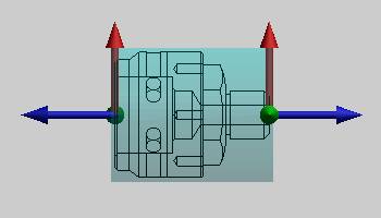

  1. The Pick Origin box is already selected, so click the point at the center of the model to set the origin location.
The machining origin moves to the selected point.
Modify the Direction of the Machining Origin Axes
Again, we must align the machining origin to use the appropriate direction for each axis.
  1. Under Origin,click in the X Axis box, and click the point on top of the model.Be sure to select the point and not the line.
Notice we can select a point (or a vertex)to set the direction of any axis.
  1. Click in the Z Axisbox, and click to select the line on the side of model.
The Z-axis now aligns to the selected entity direction, and our machining origin if properly defined.You should have the same axes directions as shown in the previous image.
Note: We are creating the same alignment for the front and back machine setups (the X-axis and Z-axis) as shown next.When creating turning features, the part profile is analyzed starting from the XZ plane.
Again, if using sketch geometry for our profiles, they are aligned to the XZ plane.
We want this machining origin to be zeroed at the face of the part, so next we adjust the origin location as we did for the first machine setup.

  1. Press Ctrl+1to select the Front view.
  1. Under Origin, clickEnter Origin.
  1. Next to X, click the up arrow once to change the X value to 0.000.
The machining origin updates to the backface of the part.(The Wireframe view is used to better show the new location in the following image.)
