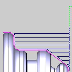

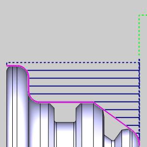

Pattern
The Pattern allows you to select how the passes are laid down.
Standard - Each
pass will be parallel to the center of rotation.

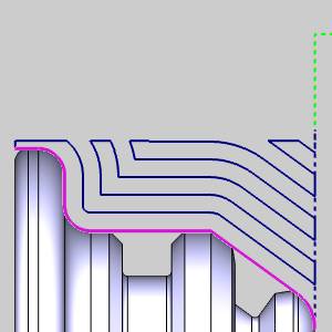

Offset - Each pass
will be an offset copy of the selected geometry trimmed to the feature
constraints.
| Standard | Offset |

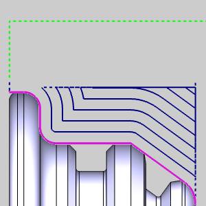

Sorting
Sorting allows you to select how the passes link to the following pass.
Standard - defines
a one-way cutting pattern with retracts between each cut.
Zig Zag - defines
a two-way or alternating cutting pattern.
In the table below you can see how these sorting options affect the selected patterns.
| Standard Pattern | |
With Standard Sorting |
With Zig Zag Sorting |
| Offset Pattern | |
| With Standard Sorting | With Zig Zag Sorting |

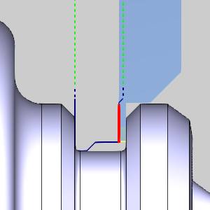

Compensation

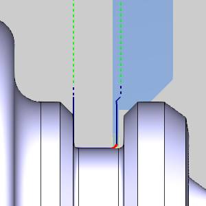

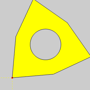

Each tool has a theoretical point placed on it as seen in red in the animation below. In the case of tools with a radius of any size, this point is not actually on the tool, but on the horizontal and vertical intersections of the radius. It is this point that the toolpath plots out. When compensation is used, it is designed to place the actual tool and not just its theoretical point on the geometry. This can be accomplished with System Compensation, Machine Compensation, or a combination of the two.
System Compensation
Off - the selected geometry is used as the program path; Machine Compensation should be used.
On with Collision Detection - the system compensates for the tool nose radius and the insert geometry and avoids any detected collisions.
Use Tool Holder - a collision check is done on the holder, and the toolpath is adjusted to ensure the tool holder does not collide with the geometry. -
On without Collision Detection - the system compensates for the tool nose radius and the insert geometry without checking for collisions.
| System Compensation: | |||
Theoretical Point |
Off |
On with Collision Detection |
On without Collision Detection |
