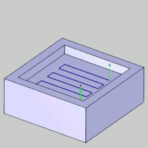

    • Morph Spiral - creates a pocket pattern which combines a spiral and the offset shape of the pocket in order to eliminate linking moves. A morph is only applied in situations creating a closed contour. Open pockets will not always be able to utilize the morph pattern.

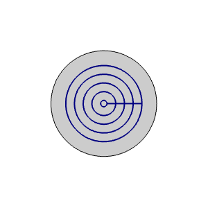

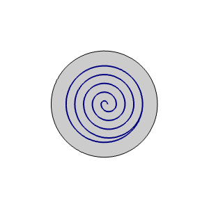

  • Use Spiral for Circular Pockets - Spiral pockets give the user the ability to create spiral toolpath instead of the standard offset toolpath for circular pockets.
    Select the check box to a override the previously selected pattern in favor of a spiral pocketing method on circular pockets.
    While  the check box remains unselected, the currently selected pattern will be applied to all geometry, including circles.
    ClosedClick here to see a comparison between offset and spiral pockets.
    Offset
    Spiral

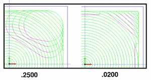

  • Minimal Curvature Radius - determines the smallest radius used in the toolpath motion. This value must be greater than zero, but be aware that if you set this value too high, no toolpath is created. This parameter is useful, for example, to determine how far into a corner the toolpath can reach.

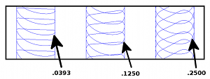

  • Smooth Connections
Select the check box to apply a tangent move to the link connection. The specified radius can be anywhere from 0, to half the step over. Notice in the animation below, arcs of a specified size can be applied to the link move.
Clear the check box when not utilizing a smooth connection.
Note: The Smooth Connections option is only available when an Advanced Pocket / Parallel Pattern is used, and One Way Cut Direction is turned off.
