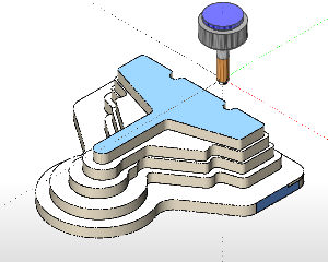

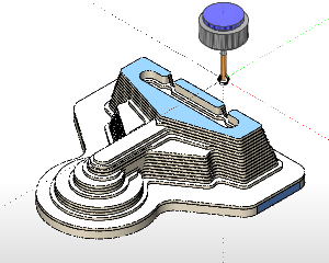

  • Num. of Intermediate Steps - the number of intermediate slices to be added between each step in the Z-axis.
    • Intermediate slices can be added to roughing toolpath to reduce the staircase effect.
      • Less material remains for smaller tools while rest-roughing
      • Uniform thickness for semi-finishing toolpaths
      • Uniform tool load on semi-finishing tools
      • More stock removal with larger tools with reduction in number of steps
      • Reduction in Rough machining time
    • Intermediate slices are rest roughed, meaning additional offset passes are added, if the stock remaining is more than the specified step over, to avoid excess load on the cutter.
    • Following is an image of a part being roughed without the intermediate slices followed by the an image after adding two intermediate slices.

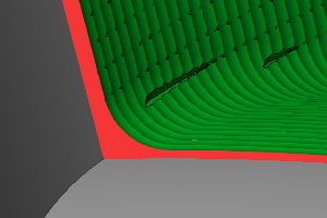

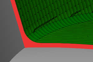

Allowance
The Allowance settings are used to define the rest material, or the amount of material remaining after this operation to be removed by the next operation, in one of two ways. These options offset the model geometry to calculate the toolpath. You can use positive or negative values to leave extra material or cut deeper than the model geometry, respectively.
Offset Type
The Offset Type determines if the allowance is applied to the entire model or separately for the bottom and sides of the part. Select one of the following options and then type the allowance value in the available allowance boxes.
  • Global - applies a single allowance value to the entire model using the Allowance XYZ value.
    • Allowance XYZ - is the amount of material left on the entire model (XYZ).
  • Side and Bottom - allows you to specify separate allowances for the side (XY) and bottom (Z) of the part.
    • Side Allowance - is the amount of material left on the sides of the part (XY).
    • Bottom Allowance - is the amount of material left on the bottom of the part (Z).
