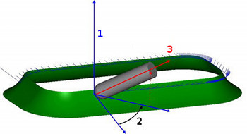

  • In the next image, the tool axis direction (3) is the same as the surface normal but a Rotation Angle of 45 degrees (2) rotates the tool orientation around the main Z-axis (1).

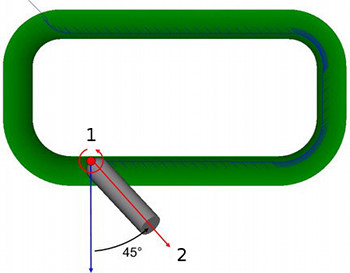

  • From the top view, you can see the tilt angle of 45 degrees (2) around the Z-axis (1).
