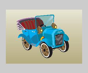

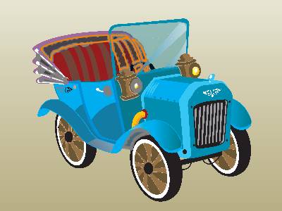

In this example, a color image of a car is used to create vector geometry.

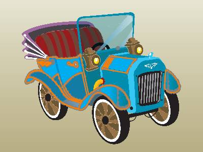

  1. In the BobART tree, right-click Images, and click Load Image.
    The Selection Manager displays for you to define the image location and orientation. You can select a plane, a planar face, or a surface edge. If you do not make a selection, the Front plane of the SolidWorks world coordinate system is automatically assigned.
  2. Select the FrontPlane from the Feature Manager design tree and click .
Note: We are selecting the Front Plane, so the vectorization result is placed in a 2Dsketch. If we didn't make a selection, the vectorization result would be placed in a 3Dsketch. (Either way the resulting geometry is the same, but working with the sketch feature in SolidWorks is slightly different.)
  1. In the Open dialog box, select the folder in which you saved the example files.
  2. At the bottom of the dialog box next to Files of Type, click the arrow, and select Windows Bitmap (.bmp) or All Files.
  3. Select Old Car.bmp, and click Open.
The image loads and displays in the graphics area. You can press the F key to activate Zoom to Fit and view the entire image.
Notice the Image-Old Car vectorization feature is added to the BobART tree under Images. BobCAM also creates a sketch feature in the Feature Manager design tree that contains the image (Sketch Picture).

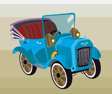

  1. In the BobART tree, right-click Image-Old Car, and click Vectorize.
    The Raster to Vector dialog box displays.

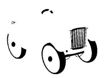

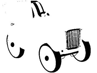

  2. Under Vectorize Strategy, notice the 2 Level (Black/White) Strategy is selected by default.
  3. In the Threshold Value box, select the text, and type 40.
    Select the text again, and type 60.
    Notice the preview of the image updates each time that you change the value.
    You can also click and drag the Threshold Value slider, in small increments, and release (to accomplish the same task).
    Change the Threshold Value to 174.
    Click OK to vectorize the image and create a sketch feature.

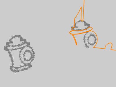

  4. Hide the image to view the geometry. (Note that when hiding the image, a red X displays next to the image icon in the BobART tree.)
    The resulting geometry is contained in a sketch feature that BobCAM automatically adds to the SolidWorks Feature Manager design tree. It is important to understand that when you edit the Vectorization parameters in the Raster to Vector dialog box, the previous result is replaced. (A new sketch feature is not automatically created for each vectorization.) This allows you to experiment with the vectorization result without creating excessive features or geometry.
  5. Next to Image-Old Car, click to expand the tree item.
    To edit the parameters, right-click Vectorization, and click Edit. This item is added to the BobART tree after the first vectorization.
    (You can also right-click Image-Old Car, and click Vectorize.)

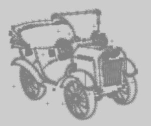

  6. Change the Threshold Value to 111 and click OK to update the vectorization result.
Notice that the geometry from the first vectorization is removed and replaced with new geometry (using the same sketch feature).
You can zoom in to view the sketch geometry and notice that a great amount of detail is already available with the geometry created using just the 2 Level Black and White strategy. At this point, we could start editing the geometry to use for other features, but instead we begin using the multi-color strategy.

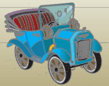

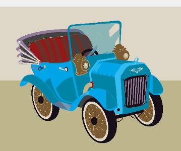

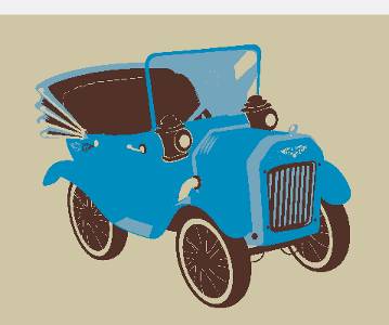

  2. Under Vectorize Strategy, select Multi-Color Strategy.
    The multi-color strategy defaults the number of colors to 64, which allows you to target very specific colors or color ranges in the image in order to be more precise with the vectorization results. Experimentation with the number of colors is an important aspect of learning to vectorize images in an efficient manner.
  3. Next to # of Colors, click the down arrow and select 32. Notice the change in the preview. For example, the gradient of the image background is reduced from 6 unique colors to 5, and the yellow and orange colors are removed from the head lights and the exhaust.
    When you change the number of colors, the image is actually reduced to the selected number of colors, and the color boxes update under Colors to be Vectorized.
  4. Continue reducing the # of Colors (for example to 16, 8, and 4), and observe the change in the preview.

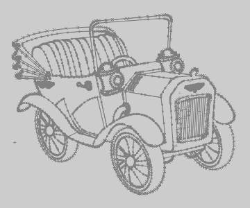

  5. Change the # of Colors to 24 and click Check All to automatically select the check box of all colors.
  6. Click OK to vectorize the image.

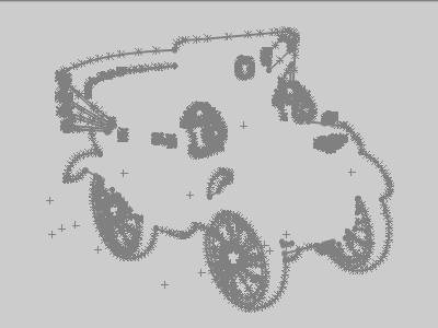

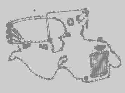

The image is processed using all 24 colors to create the vectorized geometry. Notice the horizontal lines. This is a result of the gradient in the background of the image. The current settings separated the gradient into three unique colors.
Although it is not the method used for this tutorial, you could decide that you are now done with the vectorization and simply edit the geometry. Depending on what you want to achieve, this may not be the most efficient method to use. When using this method, you are vectorizing many adjacent colors, which results in a large amount of entities. Regardless of how you choose to work, we explore another important parameter next, Remove Chains Less Than.
The Remove Chains Less Than parameter is very important when vectorizing images, as it helps you to remove unnecessary geometry that may be created from the gradients in an image.

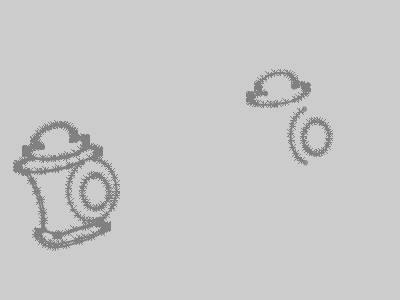

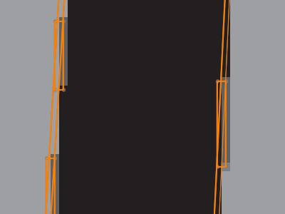

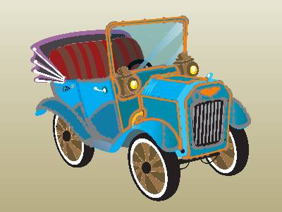

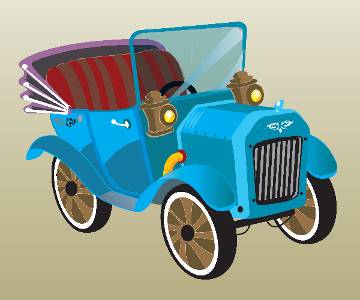

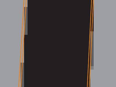

  1. Show the image, and zoom-in closely to different areas of the image and notice the geometry as compared to the selected colors (gradients). For example, the grill on the front of the car or the wheels are a great place to view how the geometry is created based on the colors.
    The following image shows the colors of the front grill zoomed in closely with the geometry hidden from view. You can see that there are actually three colors that make the vertical black and grey stripes.
    Because we have vectorized all 24 colors, the software created geometry for each color. The first point here is that you may not want to vectorize adjacent colors, as it results in what appears as duplicate geometry, although it isn't. It may be better to vectorize only one of the colors. The second point is that the darker grey color results in very small entities that are most likely not needed. The geometry from our vectorization is shown next highlighted to make it easier to view.
    You can see the small rectangles are not needed, so now we use the Remove Chains Less Than parameters to remove them.
  2. Right-click Vectorization, and click Edit.
  3. Under Vectorization Parameters, change the Remove Chains Less Than value to 100 (pixels), and click OK.
You can see that the small groups of entities are now removed from the result. You can experiment with the Remove Chains Less Than value to make the vectorization result more efficient. Next we explore more ways to be efficient with vectorization.

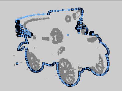

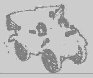

    When using this method of targeting specific colors or areas of the image, you copy and paste the desired geometry to a new sketch in order to keep it, so that it is not replaced with the next vectorization.

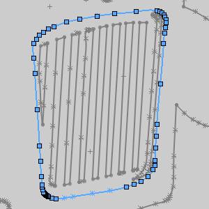

  4. Zoom-in to view the front of the car (the grill), and notice how clean the result is compared to the earlier vectorization result. There are no unwanted small entities or duplicates.

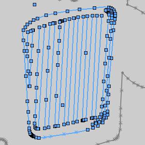

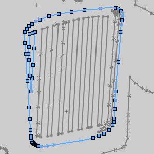

    For the next step of copying the geometry, you can either simply select the entities you want to keep, or you can edit the sketch feature to enable some more selection options. For this example, we use the Select Chain option.
  5. Click to select the outer profile of the grill.
  6. Now hold Shift, right-click the next profile, and click Select Chain.
Tip: The SolidWorks Select Chain option is a great way to obtain clean geometry from the vectorization result, whether open or closed chains, especially when vectorizing adjacent colors.

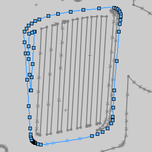

Repeat this process, holding Shift and using Select Chain to select all profiles of the grill. When they are all selected press Ctrl+C to copy the geometry.
  1. In the Feature Manager design tree, click to select Front Plane, and press Ctrl+V to paste the selected geometry to a new sketch feature (Sketch2). You can rename the feature to Grill to make it easier to remember later.
Tip: When copying and pasting geometry to keep, it is helpful to hide the new feature from view until you are finished vectorizing the image. (Right-click the feature and click the Hide icon.)
