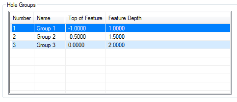

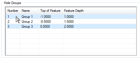

  1. First, we select a group in the Hole Groups list to show the preview of the group in the dialog box.
Note that you can click anywhere in a row to select a group, but if you click the Name, Top of Feature, or Feature Depth value, it becomes available for editing. (Either way, the group is selected when the row displays in dark blue.)
The Hole Groups preview displays directly inside the dialog box to make it easy to visualize the groups. The Group 1 preview is shown next.

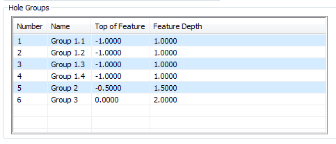

  1. With Group 1 selected, we click the Break Hole Group button.
Group 1 is separated into four single-hole groups as shown next. Again, we select the group in the Hole Groups list to display the preview.
Notice the naming of the new groups: Group 1.1, Group 1.2, Group 1.3. This makes it easy to manage the newly created hole groups.
