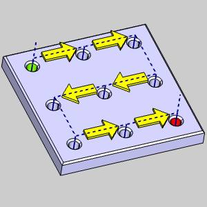

X Direction - uses the points from the selected geometry to create rows aligned with the X Axis of the machine setup. The machine sequence will then move across these rows.

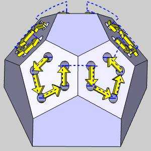

Multiaxis Drill:
Closest - This method will always try to move to the closest geometry from its current location.
Pick Order - opens the Hole Sequence dialog in the Property Manager for you to select geometry in the order it is to be machined.

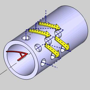

Cross Drill:

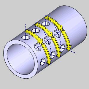

Along Rotation Axis - uses the points from the selected geometry to create rows aligned with the Rotation Axis direction as defined for the feature in the Geometry Selection dialog. The machine sequence will then move across these rows.
Around Rotation Axis - uses the points from the selected geometry to create a rows perpendicular to the Rotation Axis direction as defined for the feature in the Geometry Selection dialog. The machine sequence will then move across these rows.
Custom Direction - uses the points from the selected geometry to create parallel rows based on the angle entered relative to the rotation axis. The machine sequence will then move across these rows.

Reverse Each Operation
-  With this option selected, it forces each operation to move backwards along the path of the previous operation.
-  With this option cleared, each operation will move along the same path, in the same order.
Note: When multiple operations used in a feature, the subsequent operations in the feature will have this option available. This saves moves, since each operation does not have to move back to the start position for each operation, but can pick up where the last left off. The example below uses a 3 operation feature using an X Direction with the Zig Zag option, and starting in the Upper Left position. This will work similarly with other directions, options and start locations.

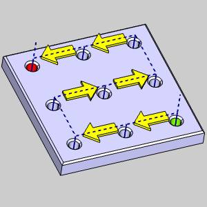

Start Location
  • Start Position - select a corner of the option box to set the starting position of the Machining Sequence.
Select one of the following options to set the machining pattern.
Note: The example below uses X Direction with the Zig Zag option. This will work the same way with other directions, and options.
Upper Left
Upper Right
Lower Right
Lower Left

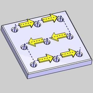

  • Zig -creates a machining sequence with one-way pattern, for example, from left to right.
Zig with X Direction
  • Zig Zag - creates a machining sequence with an alternating back-and-forth pattern.
    Zig Zag with X Direction
