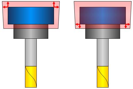

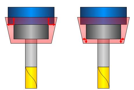

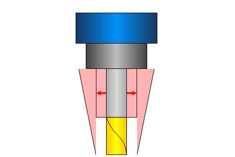

Clearance type
  • Cylindrical - applies a cylindrical offset to the holder, arbor and shaft.
  • Conical - applies a conical offset to the holder, arbor and shaft.
Clearance values
The available Clearance values define the clearance for the Shaft, Arbor, and Holder. While there is a single value available when the Cylindrical Clearance type is used, there are two values, defining the top and bottom, when a Conical Clearance value is used.
  Cylindrical Conical
  • Shaft - allows you to define the clearance used for the shaft of the tool. With the Conical Clearance type selected, two values must be defined: The Lower, and Upper Offsets.
  • Arbor - allows you to define the clearance used for the arbor of the tool. With the Conical Clearance type selected, two values must be defined: The Lower, and Upper Offsets.
  • Holder - allows you to define the clearance used for the holder of the tool. With the Conical Clearance type selected, two values must be defined: The Lower, and Upper Offsets.

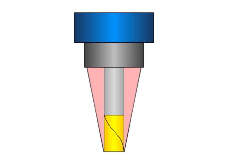

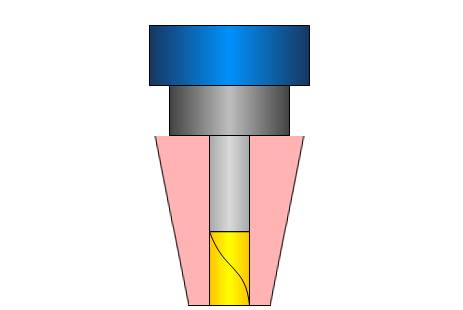

Angular clearance
The Angular clearance creates a conical clearance area around the tool. The angles origin varies based on the type of tool selected. In the case of a flat end mill, the angle will originate from the bottom diameter of the tool. In the case of an end mill with a radius, the angle will originate from the tangency of the radius.
End Mill Ball End Mill
Note:
When Angular clearance is used in conjunction with the regular clearance values, clearance values will extend the area of angular clearance.
