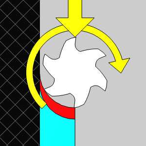

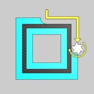

  • Climb cutting
    This method is sometimes referred to as "Down cutting". The reason for this is evident in the following image.
  • White - Tool
  • Black - Final part
  • Yellow - Tool direction/spin
  • Blue - Stock material
  • Red - Engagement area of next tooth
Notice how the next tooth will move down into the material, and how the chip will end much smaller than it starts.

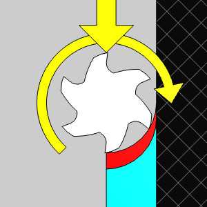

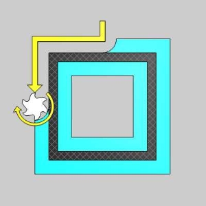

  • Conventional cutting
    This method is sometimes referred to as "Up cutting". The reason for this is evident in the following image.
  • White - Tool
Notice how the next tooth will push up into the material, and how the chip will end much larger than it starts.

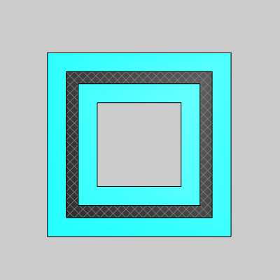

Stock:

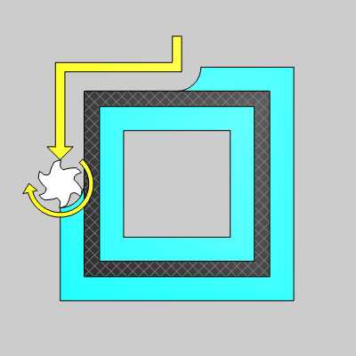

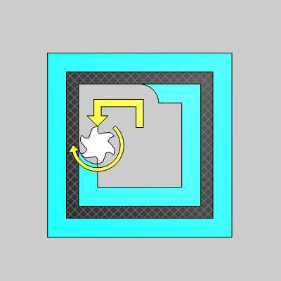

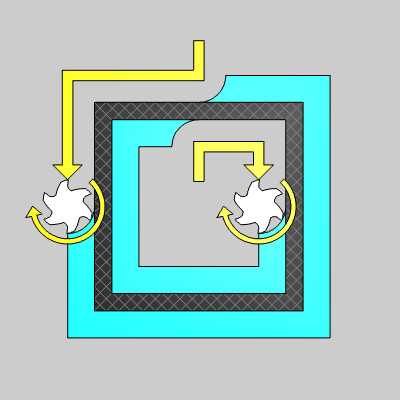

Climb cuts:
To achieve a Climb cut on an inside geometry, a counter clockwise direction used with left compensation is necessary.
To achieve a Climb cut on an outside geometry, a clockwise direction used with left compensation is necessary.
In the image below you can see how inner and outer climb cuts require opposing directions.

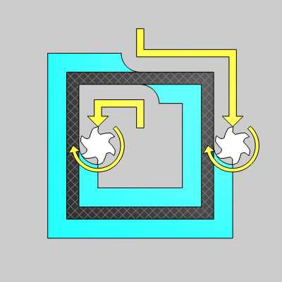

Conventional cuts:
To achieve a Conventional cut on an inside geometry, a clockwise direction used with right compensation is necessary.
To achieve a Conventional cut on an outside geometry, a counter clockwise direction used with right compensation is necessary.
In the image below you can see how inner and outer conventional cuts require opposing directions.

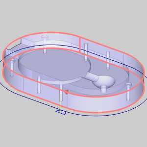

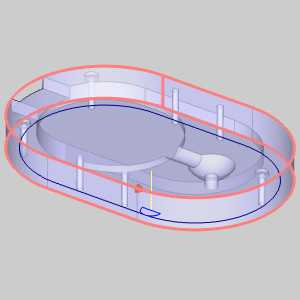

To access the compensation options:
  • In the Wizards, move to the Patterns page of the individual operations. These options can be set in the Compensation group.
Troubleshooting
The leading confusion from users just getting started with BobCAD-CAM comes into play when toolpath is computed, but it is on the wrong side of their geometry. As we learned in the above examples, this has to do with the direction of the chain versus left or right compensation. For this troubleshooting example, we will use an outside profile cut. If the cut is on the wrong side, check the chain direction; it can only be one of two things:
  • Clockwise direction with Right Compensation
    • Looking for a climb cut?
      Change the System and/or Machine Compensation to Left.
    • Looking for a conventional cut?
      Change the chain direction to counter clockwise.
  • Counter Clockwise direction with Left Compensation
      Change the chain direction to clockwise.
      Change the System and/or Machine Compensation to Right.
