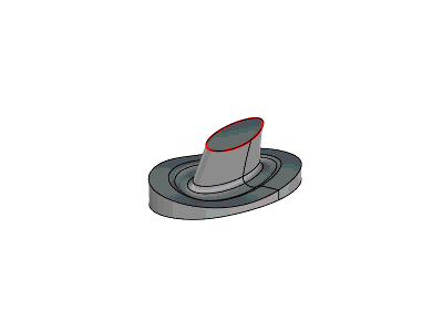

Common Direction
  • Common Direction - The aim is to find a single tool axis orientation on the full toolpath or a single contour. The option is available for all tilting strategies and alternates the tilting after the initial tilting. This means an initial tilting strategy will have to be defined to begin with, e.g. Tilted Through Point. With the Common Direction, the tool axis is set to a normalized, single direction for all toolpath points.
Select the check box to have the system find a single tool axis orientation on the full toolpath or a single contour.
ClosedClick here to see Common Direction in use.
 On all contours - will run the entire drive surface using the same common direction.
On single contours - will set the tool tilt to the average normal direction for each individual pass.

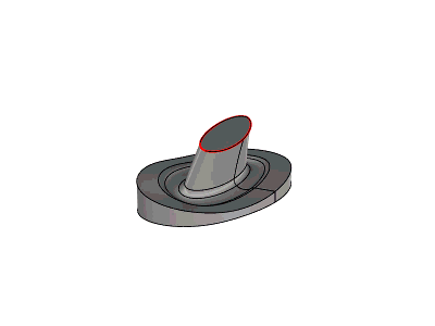

Clear the check box and Common Direction will not adjust the tilting strategy.
ClosedClick here to see default tilting strategy without Common Direction.
