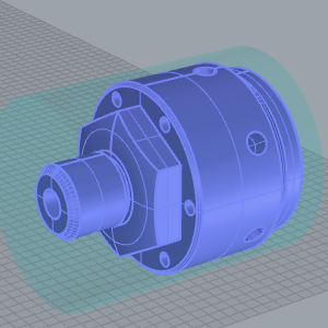

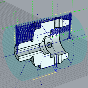

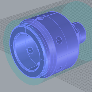

Example Part
The following images show our example part. For this tutorial, we machine the part using stock that is already cut to length. For this reason, we create our features as though the model is split into two halves: front and back. This allows us to machine the front half of the part on the main spindle before transferring the part to the sub spindle and machining the back half. This is important to understand as this determines how we create some of our features.

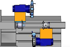

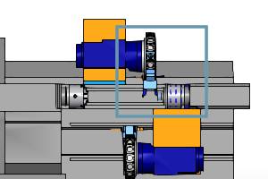

Machine Setups
For this tutorial, all features are created using one of two machine setups: one for the front side and one for the back side of the part. The following images show the location and orientation of the machining origin (work offset) for each setup.

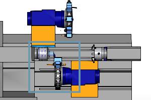

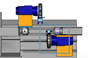

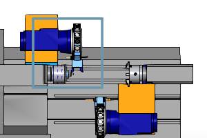

Machine Setup 1
Machine Setup 2
The Mill Turn job, stock, and machine setups are already defined in the example file provided for this tutorial. If you would like to learn more, view the Mill Turn Job Setup Example.
Final Result - All Toolpath

Part 4) Create a Turning Feature - OD Turning
Now we create a turning feature to rough and finish the outside diameter (OD) of the part. Note that we are splitting the front and back half of the part, so the front half is machined on the main spindle and the back half is machined on the sub spindle.
  1. Right-click Machine Setup - 1, point to Turn Features, and click LatheTurning.
  2. Click the Select Geometry button to hide the wizard and show the graphics area.
  3. In the Layers tab show the Front Turn layer, and hide the Solid layer.
Select the geometry as seen in the images below.
  1. To confirm the selection, click OK.
  2. Click Next>> to go to the Feature page.
  3. In the Undercut group, select the Remove Primary Undercut option.
    This will force it to ignore the groove geometry to allow us to handle that with a separate feature.

Part 10) Create a Part Transfer Using MDI (Manual Data Input)
For Mill Turn jobs, the MDI page of the wizard allows you to manually define machine movements by combining commands to create lines of code. This is used to handle machine axes movements that do not have a specific operation, such as part transfers, cutoff/transfer, parts catchers, steady rests, and tailstocks. We define our part transfer after the grooving operation as it is the last operation we perform on the main spindle before transferring the part to the sub spindle. Be sure to have your chuck jaws oriented properly in your machine definition. For more information on the chuck configuration, see The Chuck Configuration topic.
Note: You can create your own generic MDI files (templates) that are customized for your machine to handle transferring the part from the main spindle to the sub spindle. The expected workflow is to define a process once using MDI, save it to a file, then simply load the saved file and change a few values as needed per job. We do the same for this example using the generic part transfer MDI file that is installed with the software. Contact Support for assistance with MDI features: [email protected] / (727) 489-0003
  1. In the CAM Tree, right-click the last Feature Mill Hole - 6.3500 feature (that we just created), and click Edit.
    The Mill Hole Wizard displays for you to make changes to the feature.
  2. In the tree on the left, click MDI.
  1. Notice the Save/Load group under the Task List. Click the (Load) button.
The Open dialog box should display with the correct location already selected: C:\BobCAD-CAM Data\**Current Version**\Features. If not, navigate to this folder.
  1. Click to select GenericPartTransfer.bcmdi and click Open. (Alternatively, you can double-click the file name to open it.)
The Load MDI Task dialog box displays. This dialog box allows you define exactly what tasks are overwritten with the information from the file. This allows you to load individual tasks from the saved file, but for this example, we use the full replace.
  1. Click OK to replace the entire current Task List with the information stored in the file.
You can see that only the After Operation task contains any commands (it has the plus sign icon). Click the plus sign to expand the After Operation folder and view all the lines that are already defined. All of our commands are under the After Operation task, because our part transfer happens after the grooving operation.
  1. We don't need to make any changes to our generic MDI parameters, but a few of the important commands that you may adjust per job are listed next. This is shown in the video as well as how to modify the values for a command.
Important Command Values:
Command
Value
Orient Main Spindle
Angle
Orient Sub Spindle
Angle
Move Sub Spindle to Clearance
Axis
Start Fast Feed Up to Part
Axis and Feedrate
Feed to Pickup Location
Axis and Feedrate
Part Transfer
Part Pickup Position
Send Sub Spindle Home
Work Offset and Axis
Note that the number of parameters that you need to adjust depends on the way you work. Many of these values may never be changed from the values defined in the MDI template file.
Tip: You modify commands on the MDI page using the Parameters group. The general process is as follows:
• Expand a Task to view the Lines under it.
• Expand a Line to view the Commands under it.
• Click to select a Command.
• All available parameters display under Parameters at the bottom of the MDI page.
• Update the values as needed. (The changes you make are reflected in the Task List.)
  1. Click Finish to update the feature with the MDI part transfer.
Our part transfer is now output in the code, and is also visible in simulation (without MDI, in simulation the part just switches spindles without showing the transfer movement).
  1. Simulate the program to view the part transfer.

Part 15) Create a Mill Hole Feature - Cross Drilling
For the final operation, we create a drilling feature to handle the cross drilled holes in the model. Cross (or radial) drilling means that the tool axis crosses the center line of the part (the tool is parallel to the X-axis). What is important here is selecting the drilling type, Cross Drill, in the Hole Selection Manager.
  1. Right-click Machine Setup - 2, point to Mill Features, and click Mill Drill Hole.
  2. Click Select Geometry.
  3. In the Hole Selection Manager, next to Standard Drill, click the down arrow and select Cross Drill.
Important: When selecting geometry for Mill Drill Hole features, it is important to select the proper drilling type based on the orientation of the holes, as the software filters your selections accordingly. (Standard Drilling is parallel to Z-axis, Cross Drilling is perpendicular to [and intersects or crosses] the selected Rotation Axis, and Multiaxis Drilling is any orientation.)
  1. Show the Solid layer, hide the Back ID/Boring layer, and click to select the six cylindrical surfaces of the holes on the outside diameter of the part.
  1. Click (OK), to confirm the selection.
  2. Click Next>> to go to the Feature settings.
Define the Feature, Machining Strategy, and Posting Settings
  1. Under Material Approach, click Group Retracts.
Notice that our clearance Type is automatically set to Cylinder and the Radius value is 70.020. The software automatically selects a cylindrical clearance for cross drilling and sets the Radius value based on the stock and clearance settings from the Stock Wizard and Machine Setup. (Note that the Group Retracts handle the clearance movement between hole groups and not within them. The Rapid Plane determines the rapid clearance movement within hole groups.)
  1. Click OK.
  1. Under Hole Groups, click anywhere in the row of Group 1 to select it and display the hole groups preview inside of the wizard.
Notice the Diameter, Top of Feature, and Feature Depth values are all automatically set because we selected cylindrical surfaces.
  1. Click Next>>.
  1. Select the Hole template, and delete the Center Drill operation from the Current Operations list.
Click Next>> to update the wizard tree with the new template.
  1. Under Drill, click Drill to go to the Tool settings.
You can open the Tool Crib to confirm that the assigned tool is indeed mounted for cross drilling. It is important that you select a tool in the proper orientation for the operation you are creating.
Confirm that the 3/8 Drill tool is selected and click OK.
  1. Click Compute.
Part 16) Final Simulation
Important: For Mill Turn Jobs, you cannot post or simulate the program unless all tools are mounted in the Tool Crib. For example, when the software cannot find the appropriate tool in the Tool Crib during tool assignment, it assigns a tool from the Tool Library and places it under the Loose tools item in the device tree. Loose tools are tools that are assigned to an operation, but not mounted. All Loose tools must be mounted before simulating or posting. You can open the Tool Crib to confirm there are no unmounted (Loose) tools before simulating or posting the program.
  1. In the CAM Tree, right-click Mill Turn Tools, and click Tool Crib.
  1. In the device tree on the left, drag the slider down to view the Loose tools and confirm there are none. Note that there is one Loose tools item per device, so be sure to check both (all) devices for Loose tools.
Tip: BobCAD-CAM uses a special convention for Loose (unmounted) tools. The Tool Number for loose tools is -1 (negative one). When you see a tool with a tool number of -1, you know that you need to mount it (or assign a different tool to the corresponding operation). The easiest way to see where a loose tool is assigned is to open the Assigned Tools dialog box (right-click Mill Turn Tools, and click Verify Tool Assignment). This dialog box lists all features to which each tool is assigned.
  1. For our example, there are no loose tools, so we are ready to simulate the program.
  1. Right-click Mill Turn Job, and click Simulation.
ClosedView More Simulation Images
