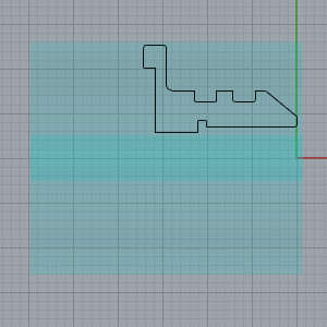

    The Stock Wizard displays.
The first page of the Stock Wizard allows you to define a Workpiece for the Turning Job and the subsequent pages handle shape, size and clearances. In this example, we will not define a Workpiece, but will define the shape, size and clearances for our stock. Once the stock has been defined you can adjust the visibility of the stock.
  2. In the Stock Type page, leave the selection on Cylindrical.
  3. Select World Right from the Stock Coordinate System list.
    The Stock is now associated with World Right.
  4. In the Size group, type in the following values:
    1. Stock Diameter = 130.175
    2. Internal Diameter = 25.400
    3. Length = 152.400
    4. Stock Origin = 3.175
  5. Click .
  6. Select World Right from the Stock Coordinate System list.
    The Machine Setup is now associated with World Right.
  7. Leave the Clearance values as they are and click OK to finalize the stock and exit the wizard.

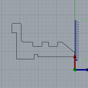

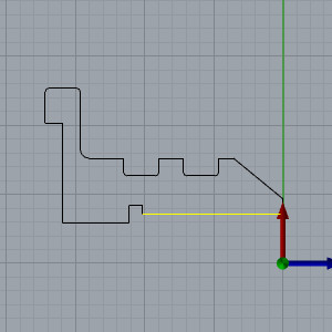

For most every Turning Job, you will need to face off the stock. By selecting a Lathe End Face feature, we will automatically create toolpath up to the machine zero without the need to select geometry. The only time geometry will need to be selected for the Lathe End Face feature is if the desired toolpath needs to end before, or, continue beyond the machine zero.
Add the Feature
  1. In the CAM Tree, right-click Machine Setup - 1 and select Lathe End Face.

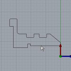

    The Lathe End Face feature launches with the Geometry Selection page active. Since our target geometry is already at the machine zero, we do not need to select geometry.
  2. Click Next>> to continue to the Feature page.
Create Feature Extensions
  1. Select the Extension check box and, in the End Distance box, enter a value of 0.1000.
Select a Tool
    The Tool Crib launches.
    The Tool Library launches.
  3. Select tool number 263 to highlight the CNMG - 3/64RAD - ROUGH TURNINGtool.
  4. Click OK to exit the Tool Library and return to the Tool Crib.
  5. Click OK to exit the Tool Crib and return to the Lathe Wizard.
  6. Select Parameters.
Adjust Parameters and Compute
Tip: In this case, we use our roughing tool to rough and finish the face. Since we use the same tool for the rough and finish, the need to create a separate finish operation is avoided by utilizing the Rough Allowance. The Rough Allowance ceases the roughing operation at the values entered and creates an additional semifinish pass up to the Finish Allowance specified next.
  1. In the Finish Allowance group, change both the Z and, X value to 0.0000.

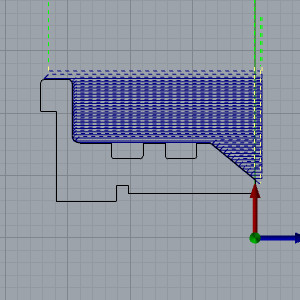

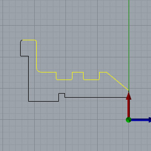

  1. In the CAM Tree, right-click Machine Setup - 1 and select Lathe Turning.

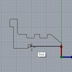

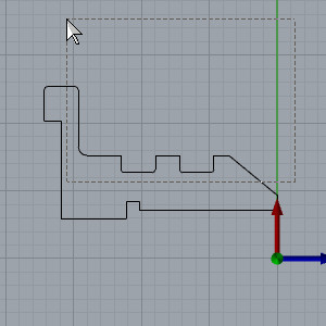

  2. Click Select Geometry.
    The Lathe Wizard hides and the Feature Geometry Picking dialog opens to allow geometry selection.

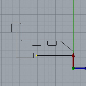

  3. In the graphics area:
    1. From right to left, window pick the turning geometry as seen in the image below.
    2. Click OK to confirm the geometry selection and return to the Lathe Wizard.
  1. In the Lathe Wizard, click Next>> to continue to the Feature page.
Adjust Feature Settings
  1. In order to avoid cutting the grooves with these operations, select the Remove Primary Undercut check box in the Undercut group.
  2. To continue beyond the selected geometry, select the check box for Extension and enter a value of 6.000 into the End Distance box.
  3. Click Next>> to continue to the Machining Strategy page.
Set the Machining Strategy
  1. Select Rough / Finish in the Machining Strategy section of the Machining Strategy page to assign a Rough and Basic Finish operation to the feature.

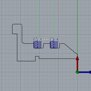

In this case, we have two grooves that need to be completed on the OD of the part and one groove on the ID. Right now we will focus on the two OD grooves.
    The Lathe Wizard launches.

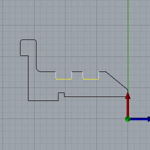

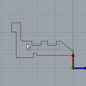

    1. Left-click and hold to the right of the grooves.
    2. Drag a window around the lower half of the grooves.
      Both grooves are highlighted.
  1. In the Feature page, under the Constraints section, select From Geometry.
  2. Select Groove.
  3. Click Tool Crib.
    The Tool Library Launches.
  5. Select tool number 281 to highlight the 1/8 WIDE - 1/64RAD - OD GROOVE tool.
  6. Click OK.
  8. Select Patterns.
  2. Select the check box for Rough Allowance and adjust the X value to 0.127.
  3. Under Semifinish Pattern, set the Overlap value to 0.127 to ensure that each of the downward semifinish cuts will go slightly beyond center.
  5. Click Compute.

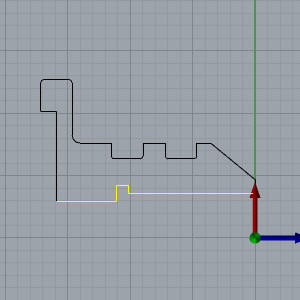

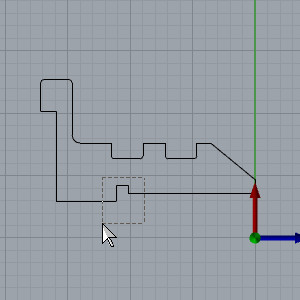

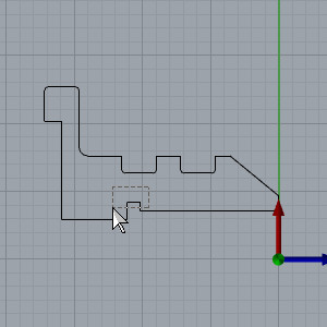

Part 6) Boring the ID
    1. Left-click and hold to the upper right of the ID groove.
    2. Drag a window around the entire groove. The groove and connected entities highlighted.
    3. Press confirm the geometry selection.
Set Feature Settings
  1. In the Feature page under Material Approach, set the Rapid Plane to 1.000.
  2. Under Feature Parameters, select ID from the Feature Type list to set the orientation of the feature.
  3. Under Undercut, select the Remove Primary Undercut check box so that our rough does not try to complete the ID groove feature.
  4. Select the check box for Extension and enter a value of 12.000 into the End Distance box.
  5. Select Rough.

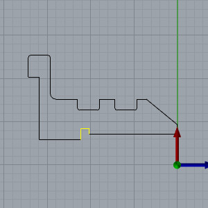

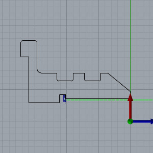

Part 7) Grooving the ID
  1. In the Feature page, under Material Approach, set the Rapid Plane to 1.000.
  3. Under Constraints, select Custom and then click Pick since the material has already been removed for a portion of this geometry, we can change where the toolpath begins.
  4. Highlight the connecting entity to the right of the groove, and left-click.
  5. Confirm the geometry selection.
    The Lathe Wizard returns.
  6. Select Groove.
Select a Tool
  1. Click Tool Crib.
  2. Click GROOVE and then click Add From Tool Library.
  3. Select tool number 280 to highlight the 1/8 WIDE - 1/64RAD - ID GROOVE tool.
    In the Tool Crib:
    2. Click OK.
  5. Select Parameters.
Set Parameters and Compute
  1. Select the check box for Rough Allowance and adjust the X value to 1.000.
  3. Click Compute.
Blank Toolpath

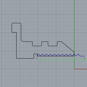

  1. In the Feature page, under Feature Parameters select ID from the Feature Type list.
    1. In the Start Distance box enter a value of 9.000.
    2. In the End Distance box enter a value of 0.750.
  3. Select Thread.
  1. Under Parameters, set Threads Per Unit to 0.197.
  2. Select the check box for Override and set Thread Height to 3.023.
Important: The Thread Height that is calculated in BobCAD-CAM is the theoretical sharp height. Depending on the thread being cut, you may need to adjust this value.
  1. Click Compute.

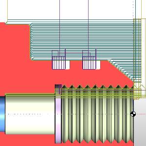

Part 9) Simulation
Open and Close Simulation
  1. In the Modules menu, click Simulation.
For help with simulation, view Getting Started with Simulation.
Tip: The Simulation contains a CutSim tab. Clicking on the Advanced Properties button will launch the Parameters dialog box allowing you to select the Enable check box in the Section plane group. This will put the stock in the section plane view seen in the image above. Leave the values as they are and click OK.
