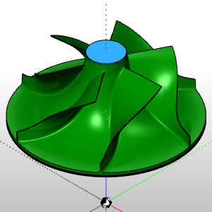

In this example, you create toolpaths that can be used to rough and finish the impeller.

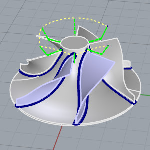

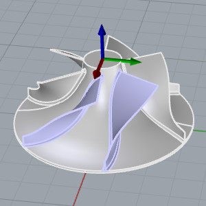

Part 6) Part definition
  1. Click the Part definition tab.

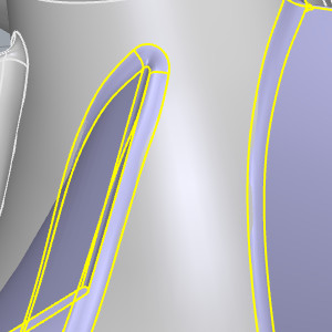

  2. Click the ellipses button next to Blades,splitter,fillets to select geometry for the feature.
    The Re/Select Geometry dialog appears.

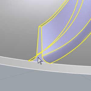

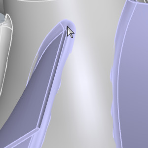

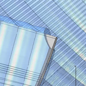

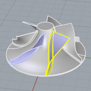

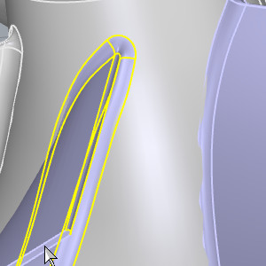

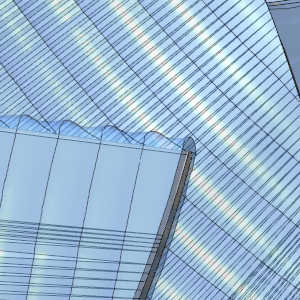

  3. Select each surface of the two differently colors blades.
    Be sure to select the shroud surface shown in the above image.
    Selecting the surface in the image below is not necessary.
  4. In the Feature Geometry Picking dialog, click OK.

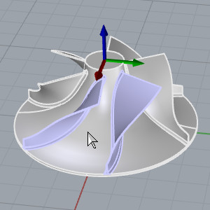

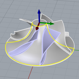

  5. Click the ellipses button next to Hub.
  6. Select the surface of the hub.
  7. In the Feature Geometry Picking dialog, click OK.
  8. Next to each of the geometry selection buttons is a Stock to leave value. Set both of these to 0.030.
  9. At the bottom of the Part definition group, set the Number of segments value to 6.
  10. In the Segments group, set Machine to All.

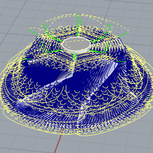

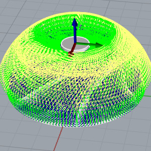

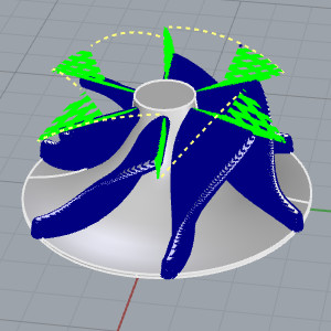

  1. Click Compute.
Part 7) Simulation
  2. Click Play to view the Roughing operation in simulation.
    This will allow you to ensure this operation is free of collisions.

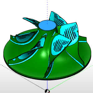

    In this case, we can see there is indeed an issue with the cut.

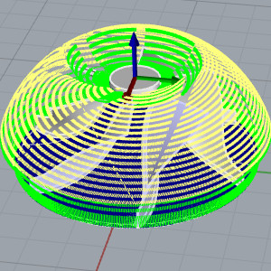

Part 8) Adjust the Parameters and Compute
  1. In the CAM Tree, right-click the Feature Multiaxis and select Edit.
    The Mill Multiaxis Wizard appears.
  2. Click Parameters in the tree on the left.
  3. In the Sorting group, change Method to Zig-zag, start from leading edge.
  4. Click on the Tool axis control tab and change the Side tilt angle value in the Tilting group to 0.
  5. Click on the Edges tab and change the Radial/Trailing edge value in the Edge extension group to 0.250.
  6. Click Compute.
Part 9) Simulation
    We can see this has corrected the gouge issue.

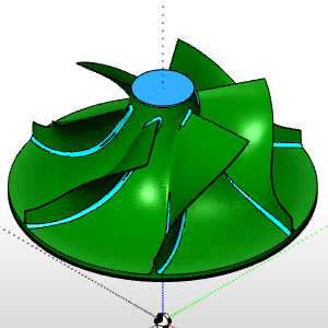

Part 5) Simulation
  2. Click Play to view the Finishing operation in simulation.
    This will allow you to ensure this operation is free of collisions and to check the deviation report to verify removal of all the material.
  3. Once the simulation is finished click in the Analysis tab and choose Deviation from the drop down list.
  4. Click Min/Max Detection, and then Refresh Cutsim to view the deviation report.
    Notice the hub surface is right where we need it to be.
