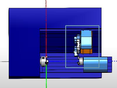

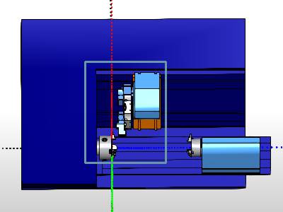

BC 1T 2S Mill Turn Machine
This example uses the BC 1T 2S Mill Turn machine.
BC 1T 2S Submachine Naming
The submachine naming used for the BC 1T 2S is as follows.

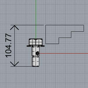

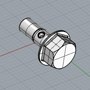

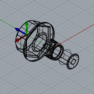

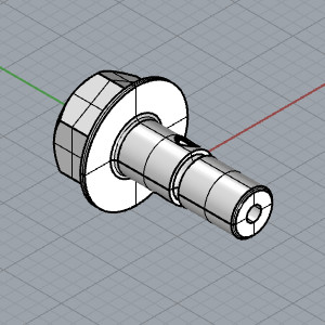

Example Part
The following images show our example part. For this example, we machine the part using stock that is already cut to length. For this reason, we create our features as though the model is split into two halves: front and back. This allows us to machine the front half of the part on the main spindle before transferring the part to the sub spindle and machining the back half. This is important to understand as this determines how we set the needed values.

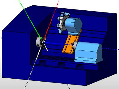

Machine Setups

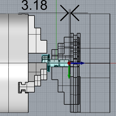

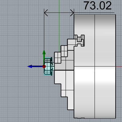

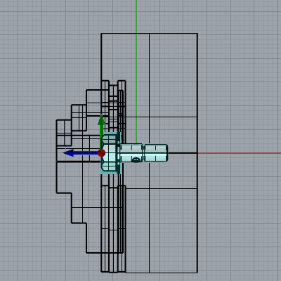

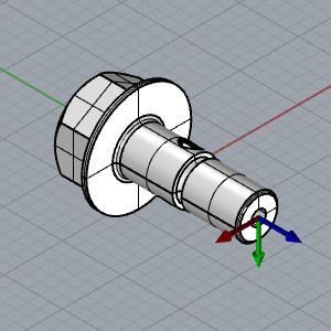

For this example, all features are created using two machine setups: one for the front side and one for the back side of the part. The following images show the location and orientation of the machining origin (work offset) for each setup.
Machine Setup 1 (UT_MS)
Machine Setup 2 (UT_SS)

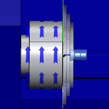

When simulating your machine, it is important to have the proper work offset values. In a Mill Turn job, whether you are working on the main spindle, or the subspindle, the machine setups are placed at the center of the appropriate spindle chuck face. The Work Offset values allow you to compensate for this by specifying the values to offset the position of the machine setup by. First we simulate to note the current state, and then alter the Work Offset values for the first Work Offset.
Simulate
  1. In the CAM Tree Manager, right-click Mill Turn Job, and select Simulation.
    The Simulation launches.
  2. Notice the stock, and associated toolpath, are all inside of the main spindle.
    This is because of the default Work Offset Z value of zero lining our Machine Setup with the center of the chuck face.

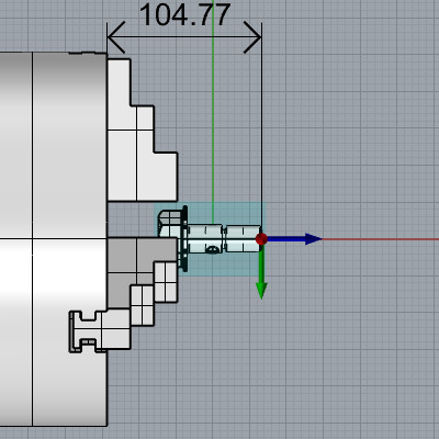

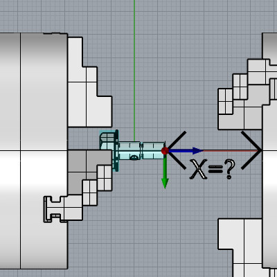

  3. Set the Z value to 104.775.
    This positions the machine setup, and therefore the part and the stock, as shown in the image below.
    This should give us sufficient material to hold on to, while exposing enough material to complete the work on the first setup without contacting the chuck jaws.
Tip: It can be helpful to draw a quick sketch of the jaws being used in the chuck to determine how far out to position the machine setup from the spindle chuck face. This is shown in the image below. To find out more about defining chucks and chuck jaws, see The Chuck Configuration Dialog topic.

  3. Set the Z value to 73.025.
    Again, this specifies the distance the Machine Setup should be offset from the spindle chuck face.
Work Offset value: 0.00 Work Offset value: 73.025

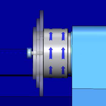

    While each line can be tailored to your needs, the main items for viewing the movements in the simulation are:
    1. Move Sub Spindle To Clearance.
      This is designated as the rapid move toward, but still a safe distance from, the part.
    2. Start Fast Feed Up To Part.
      This is designated as a faster feed move to get closer to the pickup location.
    3. Feed To Pickup Location.
      This is designated as a slow feed move to the final pickup position.
    4. Part Transfer.
      This is what moves the part in the simulation, and the value should match the Feed To Pickup Location value.

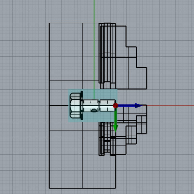

    We use this value because our jaws, in this case, are 47.625 from the face of the spindle.
  5. In the Task List, expand Feed To Pickup Location.
    Four commands appear.
  6. Click on Axis, and set the Axis Value in the Parameters group to 3.175.
    We only use this value to leave a little space behind the head of the bolt as seen in the image below.
