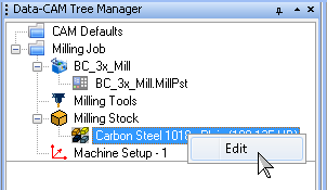

Part 5) Select the Stock Material
Selecting the appropriate stock material for the job determines the values used for automatic speeds and feeds calculations in the Milling Wizard. This information can be customized using the Stock Material Library.

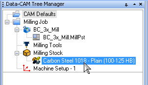

1      In the CAM_Tree_Icon_BBCD.png CAM Tree, right-click the current Stock_Material_Icon.png Stock Material, and click Edit.

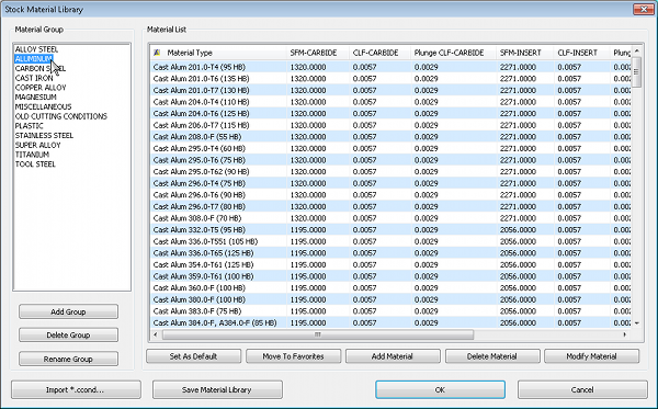

2      Under Material Group, select Aluminum.

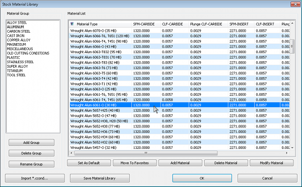

3      In the Material List, click Material Type to sort the list, and select Wrought Alum 6061-0, and click OK.
