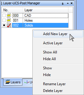

Create a CAD Layer and Set as Active
1      Right-click in the Layers_Manager_Icon.png Layers Manager, and click Add New Layer.
2      To name the layer, type Facing, and press Enter to finish.
3      Next to Facing, click Layer_Icon.png.
The icon changes to Active_Layer_Icon.png to indicate that this is the active layer.
