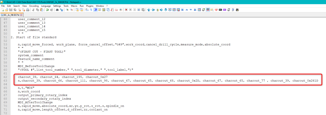

Block 228. Support Unicode Output?
This Post question tells the posting engine to support unicode characters or not. This is mainly used for developing post processor that will be used in non-English territories where the software is not in English.
Available Options:
y - This setting sets the posting engine to support Unicode characters
n - This setting sets the posting engine to not support Unicode characters.
SPECIAL NOTE: Some CNC controllers will not accept unicode characters. This option allows the post writer to disable support for these characters and they will be omitted from the output thus removing potential errors at the machine controller.
With this support Unicode Post question is set to "Y", the charout_xx Posting variable can output of special characters in the posted Gcode program by specifying its Unicode value. It is important to understand charout_xx variable output is linked with this post question 228. If the post processor is set to only support ASCII characters, charout_xx cannot output characters from the higher Unicode set of characters apart from the ASCII characters.
 The following is an example usage of this Post question 288 and the charout_xx posting variable.
Add the lines below to the Post Processor under the block 2 as shown in the picture
charout_39, charout_64, charout_195, charout_0x27
n,charout_39, charout_66, charout_111, charout_98, charout_67, charout_65, charout_68, charout_0x2D, charout_67, charout_65, charout_77 , charout_39, charout_0x261D
We get the following result depending on the setting of question 228.
                 228. Support Unicode Output? y                                        228. Support Unicode Output? n

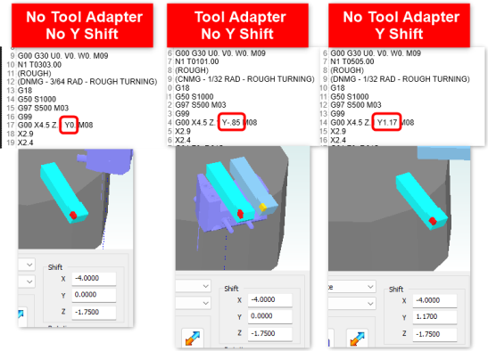

Block 3560. Output Lathe Tool Y-Shift in the g-code?
This post question controls the Lathe Tool Y-Shift g-code output. This question is needed on some machines when utilizing a lathe dual tool holder. Since the Lathe tools are not centered on the mounting point of the station, the g-code needs to reflect that shift in Y. This Y-shift value can be controlled 2 different ways.
  • 1st Way: If this post question is enabled, if you have a tool adapter setup in the tool crib, it will automatically post out the Y-Shift based on the position of the lathe tool in the tool holder and the center point of the station.
  • 2nd Way: If this post question is enabled and you do not have a tool adapter setup. You can use the Y "Shift" section of the tool crib to manually input the Y-Shift.
In the Post Processor:
3560. Output Lathe Tool Y-Shift in the g-code? "y"
Job Type:
  • Mill Turn
Valid Options:
  • "y" - This setting turns on the Y-Shift
  • "n" -This setting turns off the Y-Shift
