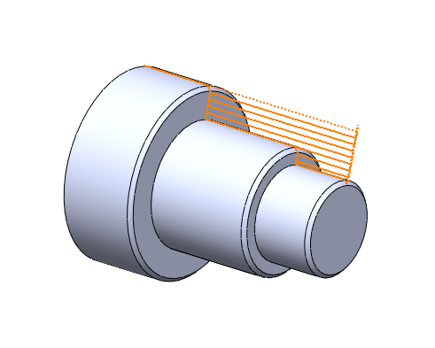

The following image shows an example Rough toolpath.

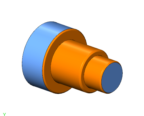

The following image shows the part after simulation.
