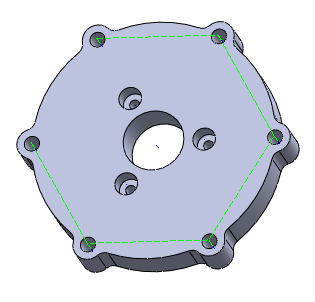

To associate the geometry with the feature:
Click Select Geometry
Select the face of each of the six drill holes as shown next:
Click
Next, Finish
to exit the Hole Wizard

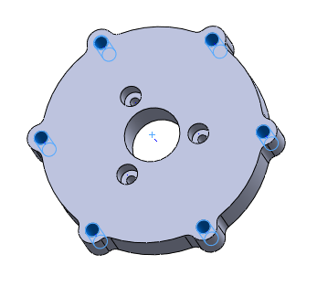

To compute the toolpath:
In the
CAM tree, under
Feature Drill Hole, right-click Drill
Hole, click Compute Toolpath
The result should look like the following image:
