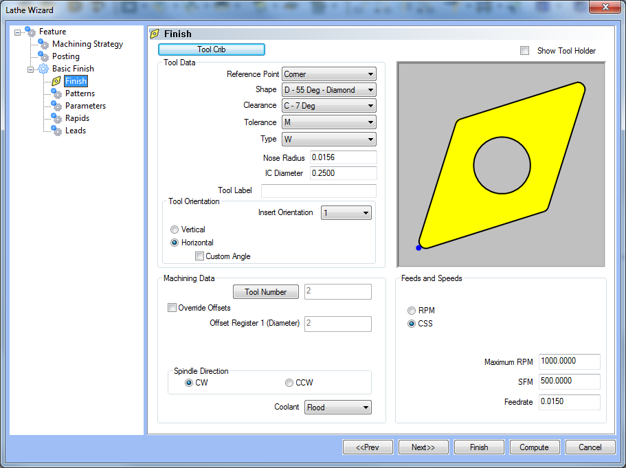

The Basic Finish operation has several tools to choose from. Whether you use a Rough, Finish, Groove, or Boring tool, it is good practice to have all the tools for the job loaded into the Tool Crib at the start of the job. By this point, those tools should already be in the Tool Crib, and the system will have pulled appropriate tools for each operation from the Tool Crib. From this tool page, you can either, choose a different tool from the Tool Crib, go into the Tool Crib to add tools from your Tool Library, or enter tool specific data manually into the Tool Data Section of the page.
CheckBoxCleared.png Show Tool Holder - Selecting this check box will alter the graphic to show the holder as well as the insert.
Deselected
Selected
Deselected
Selected
LatheRoughInsertIcon.png Rough Tool Insert_Icon.png Finish Tool LatheRoughInsertIcon.png Boring Tool
LatheGrooveOpIcon.png Groove Tool
Tool Data
    Corner
    Tip
    Center
  • Shape - sets the shape designation of the insert. Click here to see chart example.
  • Clearance - sets the clearance designation of the insert. Click here to see chart example.
  • Type - sets the type designation of the insert. This does not affect toolpath or output.
  • Tool Label - adds a name to the tool, in the tool list, that allows you to easily identify the tool.
Tool Orientation
  • Orientation Number - 1-4 sets the orientation of the tool as shown in the image. This selection influences the ability of the tool to move into locations that are restricted by adjacent geometry. The options available depend on the operation type.
NOTE: The Orientation Number defines whether the cut is inside or outside of the geometry and the direction of cut and will be set for you based on the Feature Type and Region chosen in the Feature page.
  • Vertical - sets the holder to a vertical orientation.
  • Horizontal - sets the holder to a horizontal orientation.
  • CheckBoxCleared.png  Custom Angle - selecting this check box allows you to set a particular angle to the holder.
Tool Data
    Left
    Center
    Right
  • Corner Radius - sets the size of the inserts corner radius.
  • Tool Width - sets the width of the insert.
  • Tool Height - sets the height of the insert.
  • Side Angle - sets the side angle of the insert. Click here to see an example.
Tool Orientation
Machining Data
CheckBoxCleared.png Clear the Override Offsets check box to use the tool number to set the Offset Register value.
CheckBoxSelected.png Select the Override Offsets check box to allow for manual editing of the Offset Register value.
Spindle Direction
Feeds and Speeds
Once the Finish Tool variables have been set, click Wizard_NextButton.png to continue to the Patterns page.
