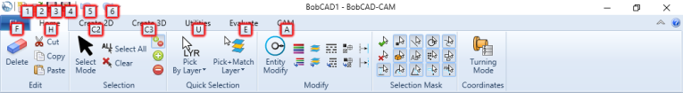

Tip: Access Keys, as seen in the image below, can be accessed by pressing either Alt+F, or Alt+Shift on your keyboard.
The Access Keys allow you to gain access to the items in the user interface without the need of a mouse.

The Home ribbon contains your edit, selection, modification and view options. To find out more detail, see The Home Ribbon topic.

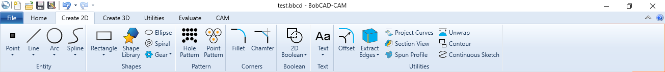

The Create 2D ribbon contains all 2D creation methods, including Patterns, and Text. To find out more detail, see The Create 2D Ribbon topic.

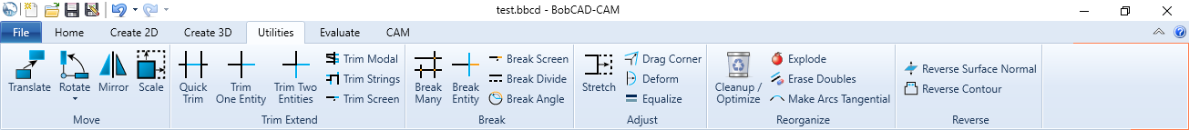

The Modify ribbon contains all the options to alter the location, size and orientation of your geometry. It also contains trimming, extending, alteration and break options. Reorganization methods can also be found here. To find out more detail, see The Modify Ribbon topic.

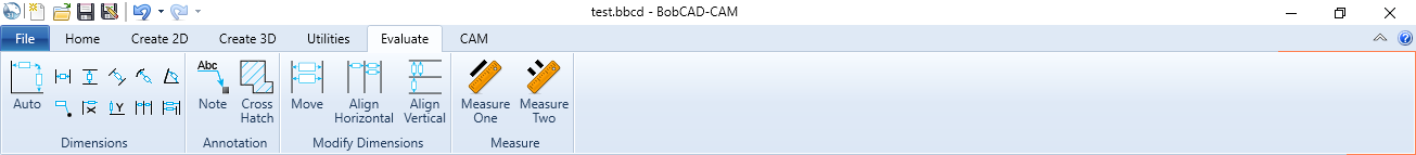

The Evaluate ribbon contains all the options to create dimensions and notations as well as your basic measuring tools. To find out more, see The Evaluate Ribbon topic.
