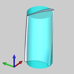

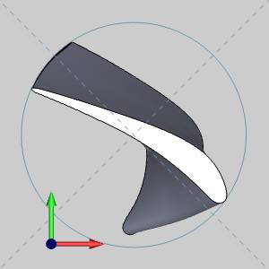

Warning: While the default Bounding Box option works fine in most cases, the image above shows a scenario in which it fails to enclose all of the geometry in the cylindrical stock. The Bounding Box  is shown with dotted lines. Notice that the Bounding Box itself encloses the geometry, while the arc that is created fails to.
  • Bounding Cylinder -  uses an algorithm to calculate the smallest possible cylinder to enclose the geometry selected with the Geometry Option to create stock.
