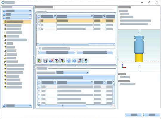

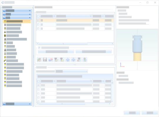

The left side of the dialog contains the All Tools list and the tools are grouped by Tool Category: Drill, Mill, Lathe, Laser, Plasma, or Waterjet. When a tool is selected from a tool category on the left, all pre-loaded tools for that tool type are displayed in the Tool Crib group, and the Tool Library group under that.
Note: When the Tool Crib is accessed by clicking Tool Crib from a CAM Wizard Tool dialog box, the list automatically shows only the available tools for that operation type.

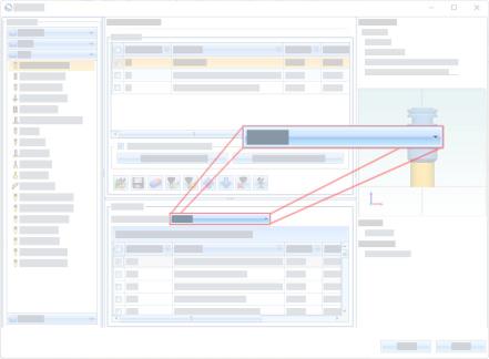

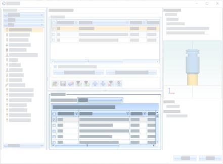

Tool Library
| Library Selection | Available tools in the Selected Library |
It is important to note, this section is not the tool crib, which contains all the tools assigned for use in the job, but a window view into the Tool Library itself. To assign tools to the job, select the tool type to see which tools of those type are available in the library. You can then drag and drop those tools into the above Tool Crib, or highlight them and click
Add tools from library to move them into the crib.

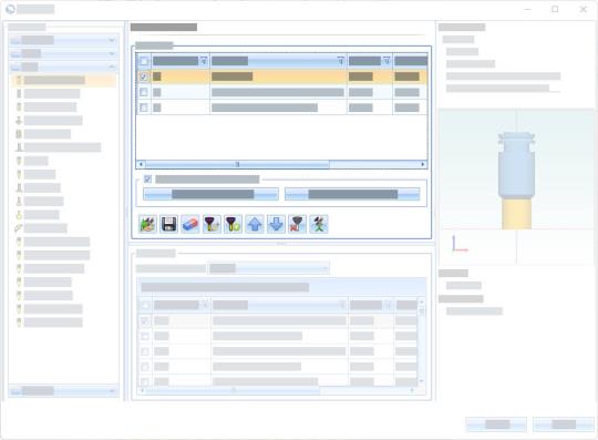

Tool Crib
This area contains all tools assigned to the job. You can select a tool in the crib to modify it, create new tools, and even add those new tools to the Tool Library.

Modify - opens the values of the selected tool in the Edit Tool Parameters dialog allowing you to edit all tool values, creating a manual tool. - OK - saves the edited tool values.
- Cancel - discards the edited tool values.
Create - opens the Edit Tool Parameters dialog allowing you to create a new tool in the Tool Crib. This can then be added to the Tool Library. - OK - saves the new tool to the Tool Crib.
- Cancel - discards the new tool.
