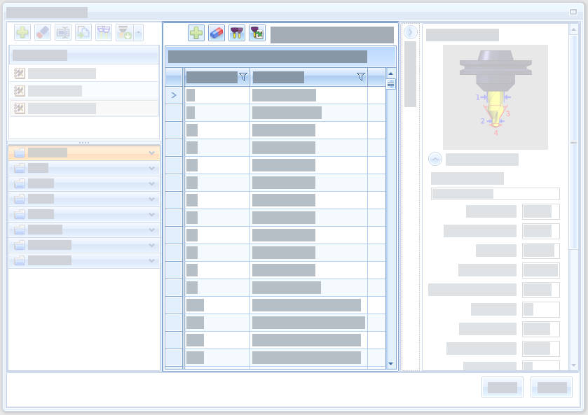

The Dialog Parameters

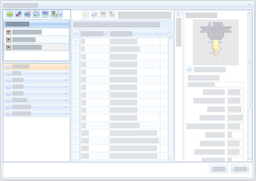

From this dialog you can view, add, delete, and copy libraries and their tools, and edit existing tools in the Tool Parameters dialog on the right, add and delete tools.
Tool Library(s)
The section on the left controls the libraries themselves.
New - creates an empty library in your list of available libraries. -
Delete - removes the selected libraries. -
Rename - allows you to update the name of the selected library. -
Copy To Other(s) - copies the selected library into other libraries. Launches the Copy tools to other libraries dialog. -
Clone - creates a copy of the selected library. -
Merge - displays the Open dialog allowing you to navigate
to and merge a previously saved Tool Library, or MachiningCloud file (.mtools, .ltools, .xml or .zip). This option will add the selected tools in the library file into the previously selected library. In the case of using the MachiningCloud .zip, selecting and opening the file will launch the MachiningCloud Import dialog.-
Import - displays the Open dialog allowing you to navigate to and load a previously saved Tool Library, or MachiningCloud file (.mtools, .ltools, .xml or .zip). This option will add the selected tool library file into your available libraries. In the case of using the MachiningCloud .zip, selecting and opening the file will launch the MachiningCloud Import dialog.
Current Tool Library
The section on the right controls the tools in the selected library.
Add tool - automatically creates a default tool and places it in the Tool Parameters section to allow you to modify it.
Delete tool - removes the selected tools. -
Clone tool - creates a copy of the selected tools. -
Copy to other libraries - creates a copy of the selected tools into other libraries. -
OK - confirms the changes made to the tools and closes the Tool Library dialog.
Cancel - closes the Tool Library dialog without saving any changes made to the library.
Tip: To share libraries between work stations, you can find the sharable files in the C:\BobCAD-CAM Data\BobCAD-CAM V37\Technology\ToolLibrary directory. By default, software is installed on the C: drive. If you have installed on a separate drive, update the above directory accordingly.
Note: The available Tool Parameters vary depending on the type of tool selected. Click on a tool to display the Tool Parameters for that particular tool.

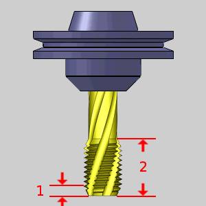

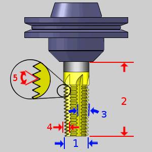

Spiral Tap
Tool Parameters
Tool Holder
- Holder
Label - displays the name of the associated tool holder.
When blank, no tool holder is associated.
- Assign/Remove Tool Holder - When no tool holder has been assigned, the Holder Label will be blank, and the button will read: Assign Tool Holder. This will open The Milling Tool Holder Library to allow you to select, or create a tool holder to associate with the selected tool. Once a tool holder has been assigned, the button will read: Remove Tool Holder. This will remove the association between the tool holder and the selected tool.
Feeds and Speeds
- Use System
Feeds and Speeds
Select this check
box to automatically calculate the feeds and speeds.
Clear this check
box to type feeds and speeds values manually. - Spindle Speed/RPM - is the revolutions
per minute of the spindle.
Custom Geometry
- Assign Tool Geometry - hides the Tool Library and opens the Tool Shape Picking dialog to allow you to select geometry from the graphics area to assign as the shape of the tool. You can learn more about assigning custom tools in the Assigning Custom Tools topic.

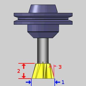

Chamfer Tool
Tool Parameters
Tool Holder
- Holder
Feeds and Speeds
- Use System
Feeds and Speeds
Select this check
Clear this check
- Plunge Feedrate - is the downward feedrate. This value is linked to the Plunge Feed per Tooth.
Custom Geometry

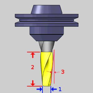

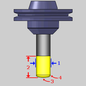

Mill
Endmill Rough
Tool Parameters
Tool Holder
- Holder
Feeds and Speeds
- Use System
Feeds and Speeds
Select this check
Clear this check
- Cutting Feedrate - is the feedrate for feed moves.
Custom Geometry

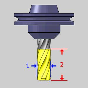

Endmill Finish
Tool Parameters
Tool Holder
- Holder
Feeds and Speeds
- Use System
Feeds and Speeds
Select this check
Clear this check

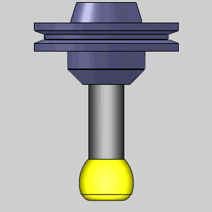

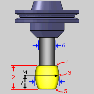

Barrel-Double
Note: To get a more in depth look at the barrel tool type, see the Barrel Mills topic.
Tool Parameters
Tool Holder
- Holder
Feeds and Speeds
- Use System
Feeds and Speeds
Select this check
Clear this check
Custom Geometry
Barrel-Section
Tool Parameters
Tool Holder
- Holder
Feeds and Speeds
- Use System
Feeds and Speeds
Select this check
Clear this check
Custom Geometry
Important: The following rules apply when creating a valid tool shape:
• Upper Corner Radius must be smaller than the Flute Length
• Lower Corner Radius must be smaller than the Flute Length
• Upper Corner Radius must be smaller than the Profile Radius
• Lower Corner Radius must be smaller than the Profile Radius
• Distance(M) Axial must be lower than the Flute Length
• Profile Radius must be greater than half of the Diameter
• Profile Radius must be greater than Distance(M) Axial
• Diameter must be greater than the Shaft Diameter
