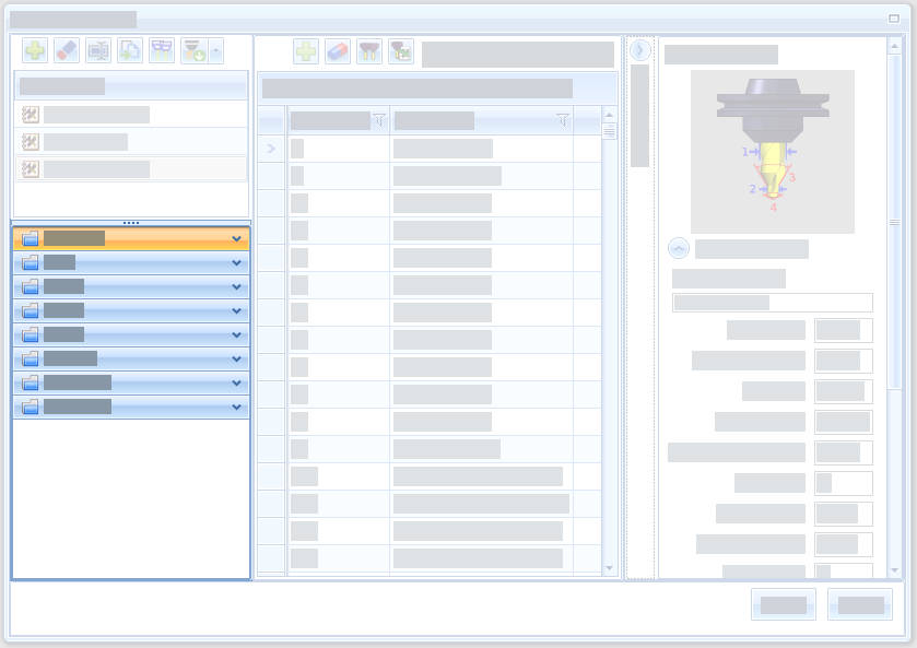

Tool Library Manager Interface
Tool Library Panel Bar
The upper-left portion of the Tool Library is the Tool Library Panel Bar which groups the available libraries. Clicking on a particular library will display the available tool types in that library. Finally, clicking on a particular tool type will show all the tools available tools of that type.
Tool Panel Bar
The lower-left portion of the Tool Library is the Tool Panel Bar which groups the tools. The tool are divided first by Drill, Mill, Lathe, Laser, Plasma, and Waterjet. Clicking on a particular group will display the available tool types in that group. Finally, clicking on a particular tool type will show all the tools available tools of that type.
Tool Grid View
With a particular tool type selected, the Tool Grid View will show all the available tools of that type. From this point you can add tools with a particular tool group selected, or highlight tools to delete, clone, or copy them to another library.

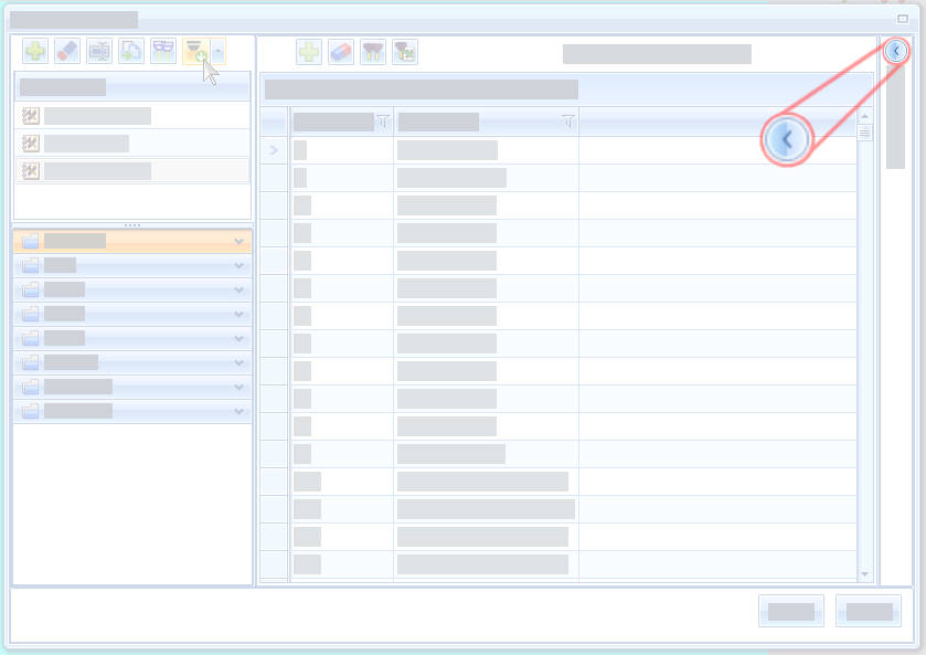

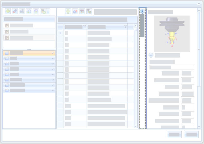

Tool Parameter Grid Splitter
Upon opening the Tool Library Manager, the Tool Parameter Dialog will be collapsed. To expand the Tool Parameter Dialog, click the
chevron icon. With the Tool Parameter section expanded, click the
chevron icon to collapse it. The Tool Parameter Grid Splitter can also be used to resize the Tool Parameter section. Hover over the left side of the Tool Parameter Grid Splitter until the mouse icon displays as the double headed arrow. You can then hold left-click and drag the section to the desired size.

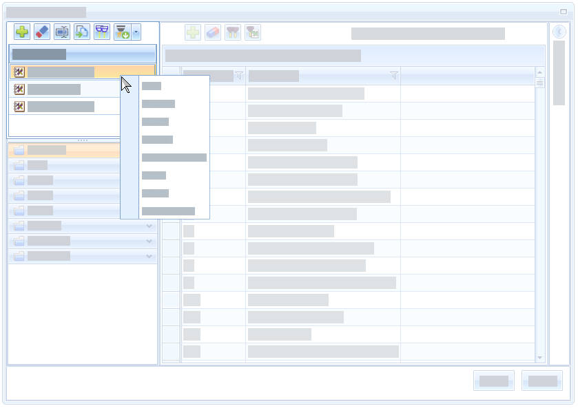

Library Controls
Note: The quick access menu options can also be accessed with a right-click through the context menu. The context menu also allows you to set a particular library as your default with the Set As Default option at the bottom.

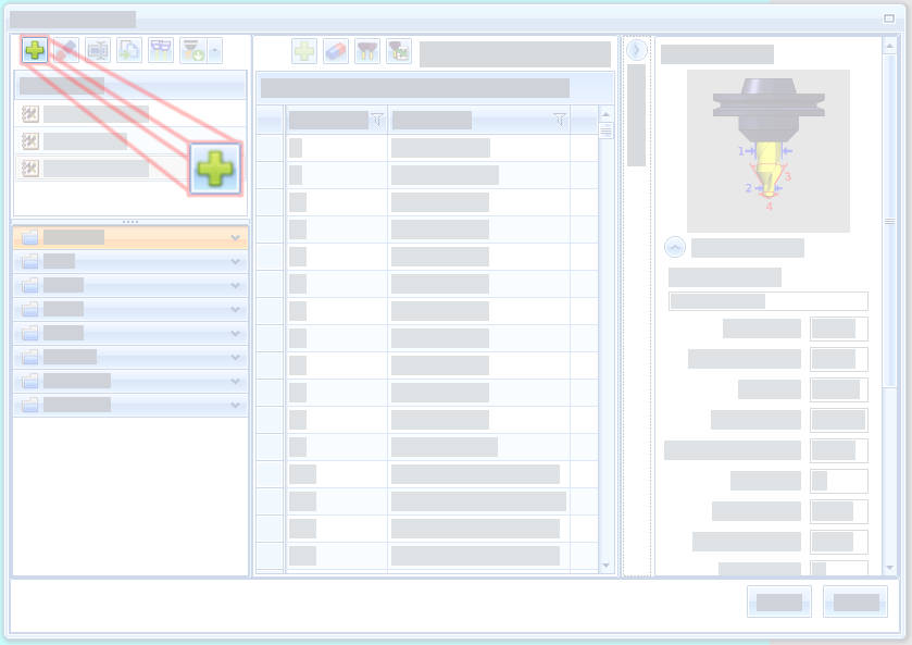

Adding a Library
To add a new library:
- Click the
Add button.
A new library appears in the Tool Library(s) list. This library will be empty up creation. - Select a job type, then a tool type, and add tools as needed.

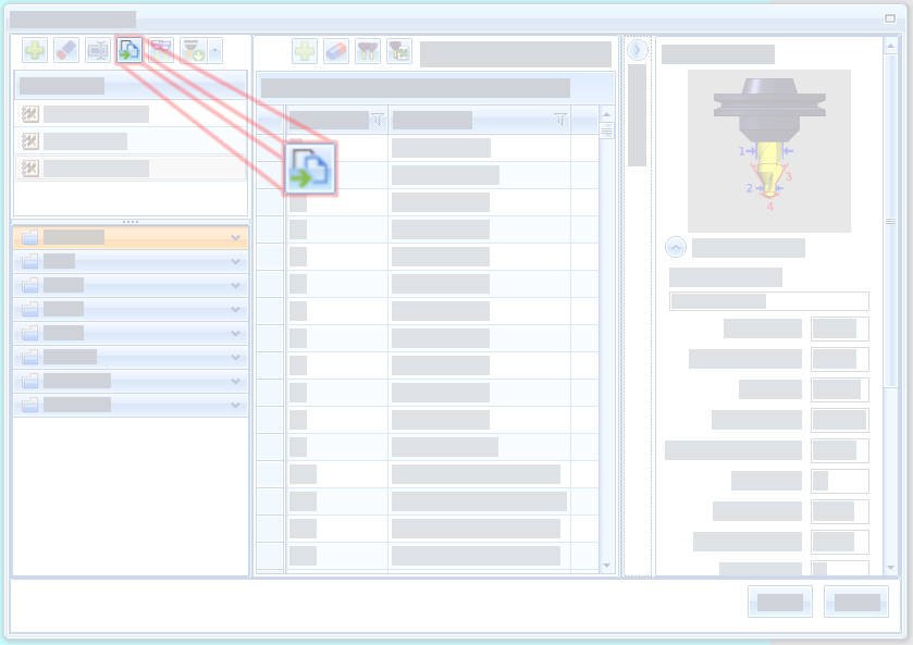

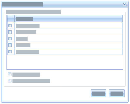

Copy to Other Libraries
To copy one library into another, or others:
- Highlight the library to be copied, and click the
Copy To Other(s) button.
The Copy tools to other libraries dialog appears.
- In the main list, select the libraries the original should be copied to.
You can also select the Select/Unselect All check box to select or deselect all libraries at once. - Select, or keep clear, the Keep same tool number check box depending on whether the tools in the original library should maintain their tool numbers.
- Click OK to copy the originally selected library to all libraries selected in the Copy tools to other libraries dialog.
The library is copied.

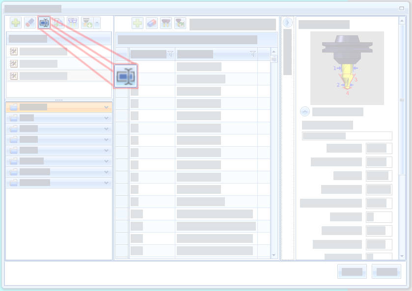

Cloning a Library
To create an exact copy of an existing library:
Clone button.
An exact copy of the selected library is created.

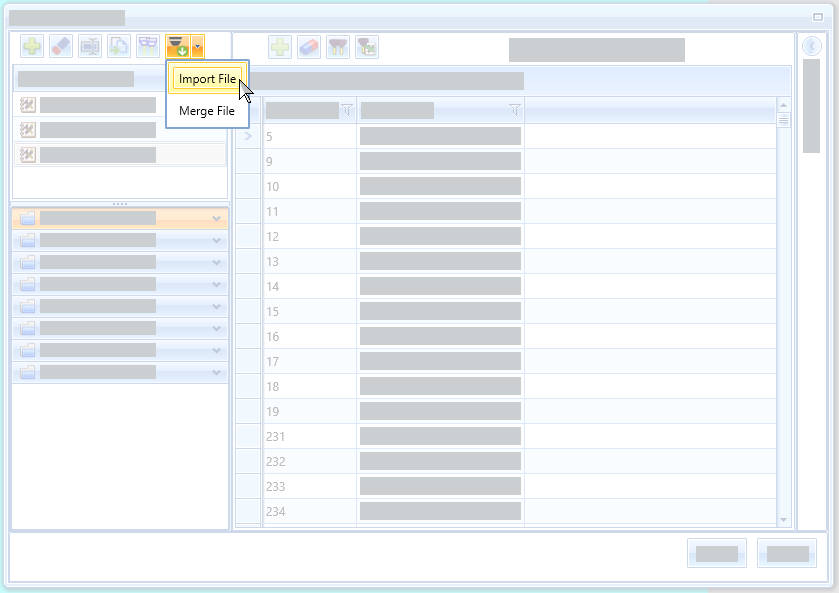

Importing a Library

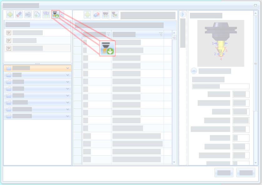

To bring in a library from another work station:
- With the library file on an available directory, click the down arrow next to the
Merge button.
The drop down options appear. - Click the Import File option.
- Navigate to the directory in which the desired library is stored.
- Select the library to be imported.
- Click Open.
The library is added to the list of available libraries.

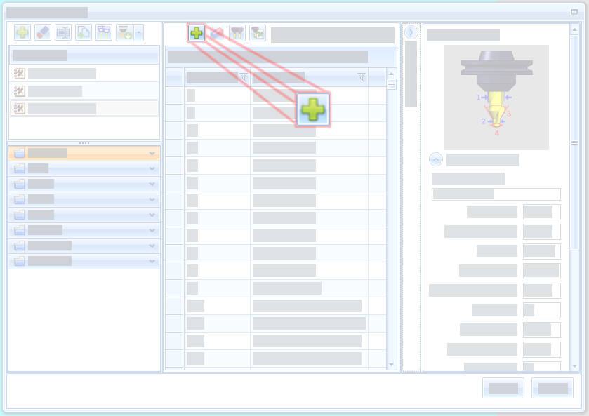

Adding a Tool
- Select the library in which the tool should be added.
- Select the tool group in which the tool should be added (e.g., Mill, Drill, Lathe, Laser, etc.).
- Select the tool type in which the tool should be added (e.g., Endmill Rough, Endmill Finish, Chamfer Mill, etc.).
- Click the
Add button.
This tool is now in the Tool Parameter Dialog to allow for editing.

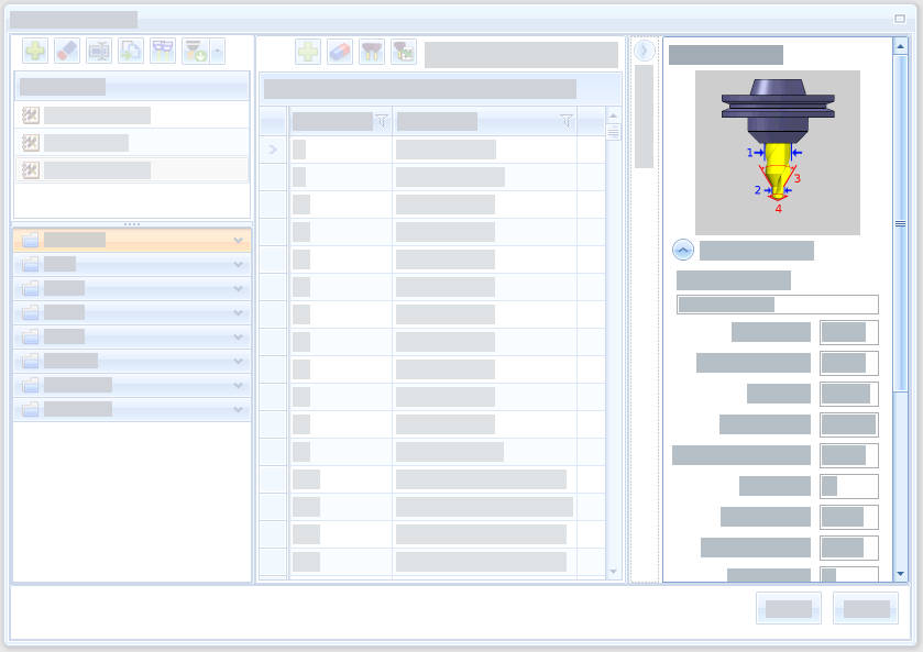

Editing a Tool
- With a tool in the Tool Grid View highlighted, click the chevron next to the Tool Parameter Dialog to automatically expand it.
You can also do this manually by hovering over the right side of the Tool Grid View and dragging it into position once the double headed arrow icon appears. - Edit the desired Tool Parameters.
- Select another tool in the Tool Grid View to update the edited tool data in the Tool Grid View, and to select another tool to edit.
- Repeat steps 2 & 3 as needed.
- With all tools edited as needed, click OK to exit the library and save the changes.

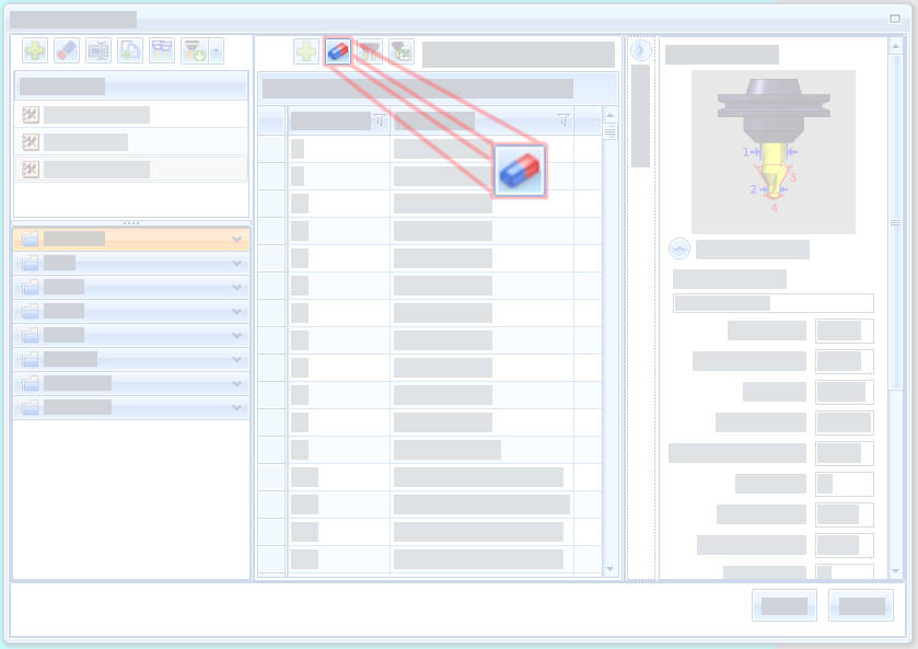

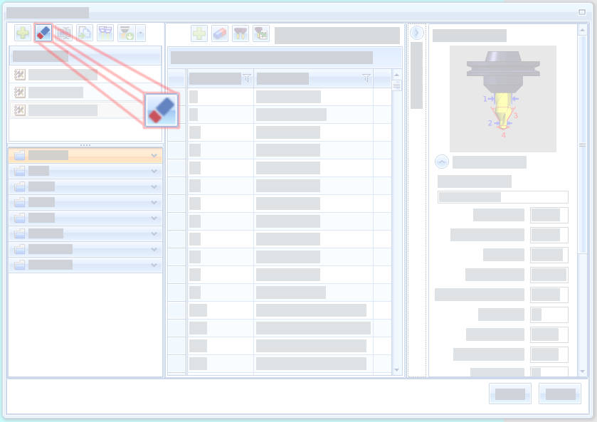

Deleting a Tool
To remove a tool from a particular library:
- Highlight the desired tool.
- Click the
Delete button.
A message box appears asking: Are you sure you want to delete this tool? - Click Yes.

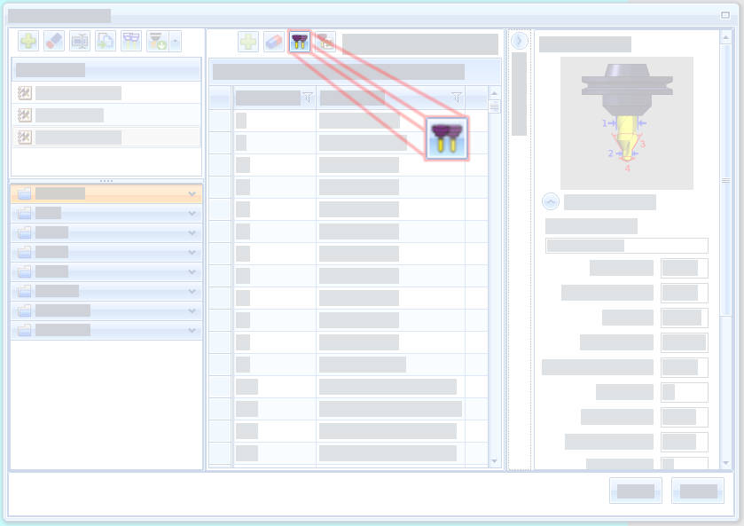

Clone a Tool
To make a copy of an existing tool:
- Click the
Clone button.
The tool is copied.

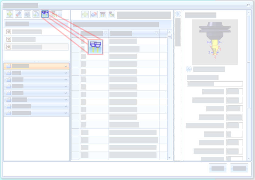

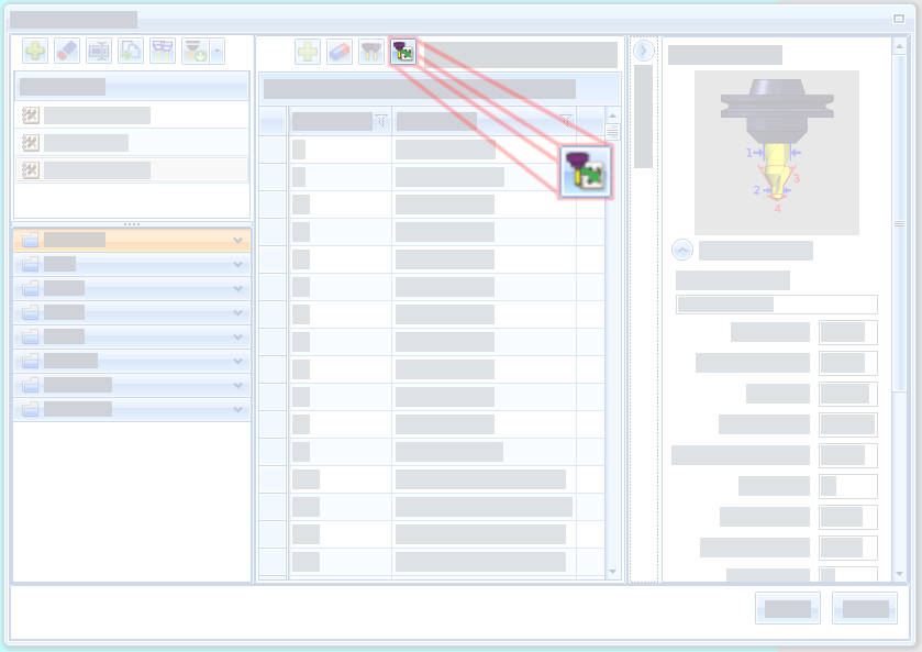

Copying Tools to Other Libraries
To make a copy of an existing tool, and place that copy into another library at the same time:
- Highlight the desired tool, or tools, to be copied.
- Click the
Clone button.
- In the main list, select the libraries the original tool(s) should be copied to.
You can also select the Select/Unselect All check box to select or deselect all libraries at once. - Select, or keep clear, the Keep same tool number check box depending on whether the tools should maintain their tool numbers.
- Click OK to copy the selected tool(s) to all libraries selected in the Copy tools to other libraries dialog.
The tools are copied.

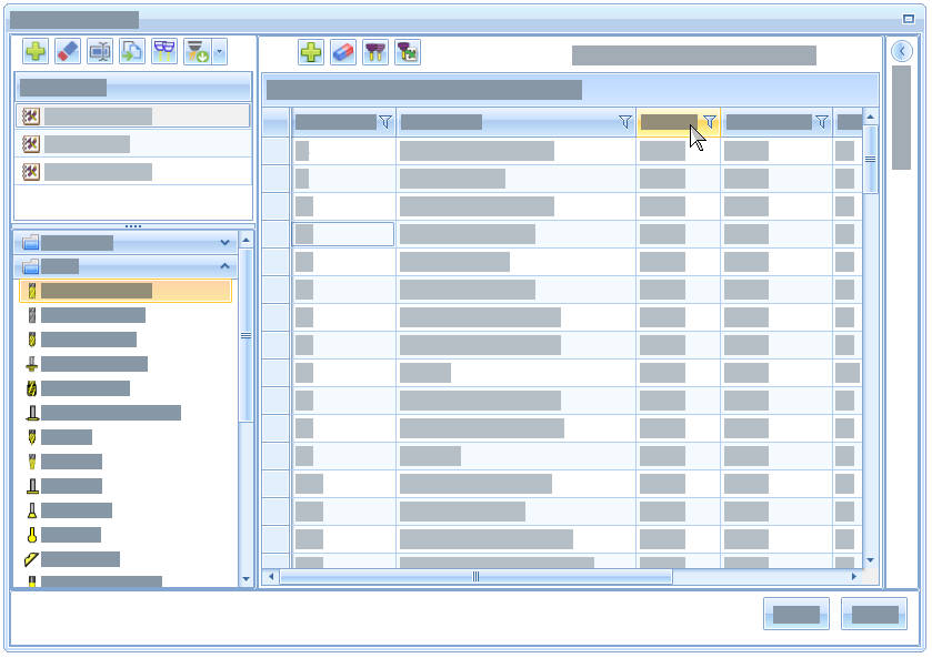

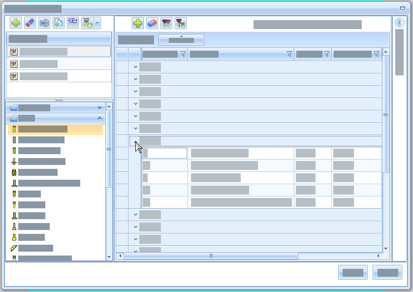

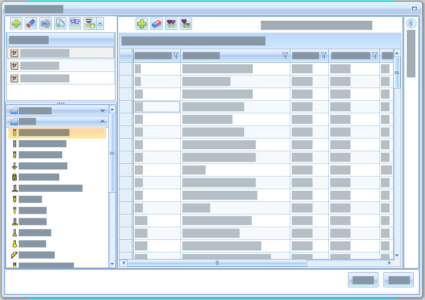

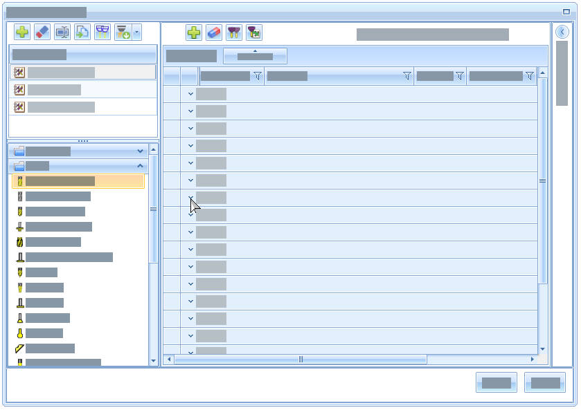

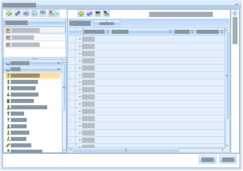

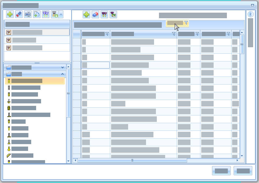

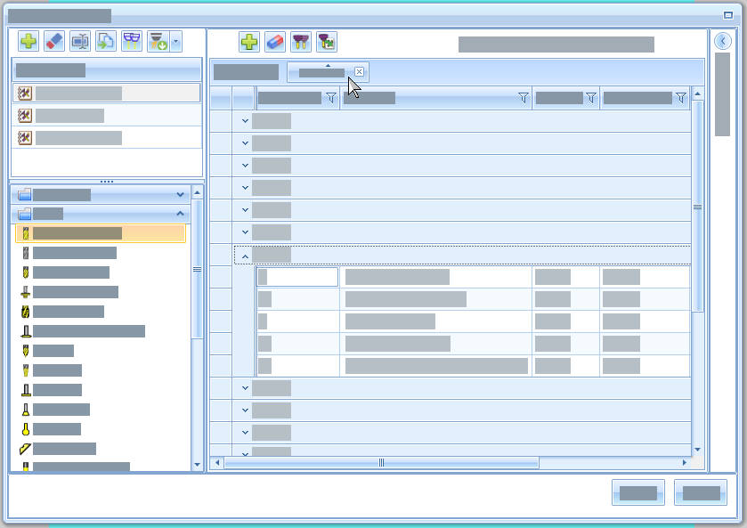

Grouping by Column
- Highlight the header you would like to use to group your tools.
- Click and hold the left mouse button while you drag the header into the area just above.
- Release the mouse to group by that column.

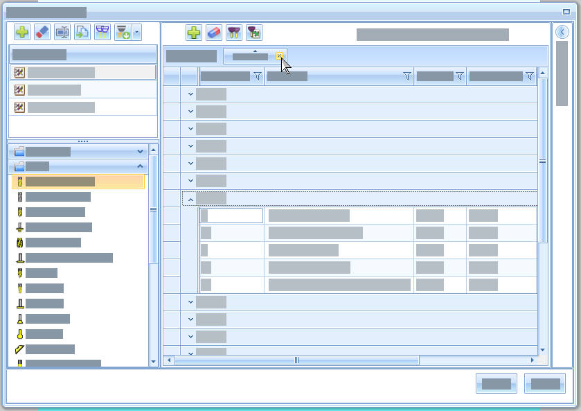

All rows are not grouped by that header and collapsed. - To expand a particular row, click the arrow as seen in the images below.
- To undo the grouping, hover over the header you dragged into the grouping area.
Notice the close button that appears on the header. - Click the close button to remove the grouping.

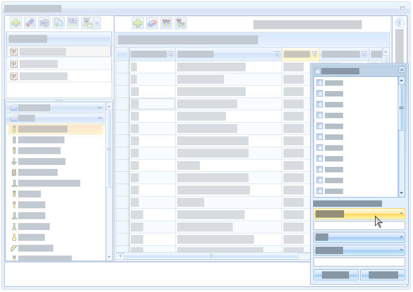

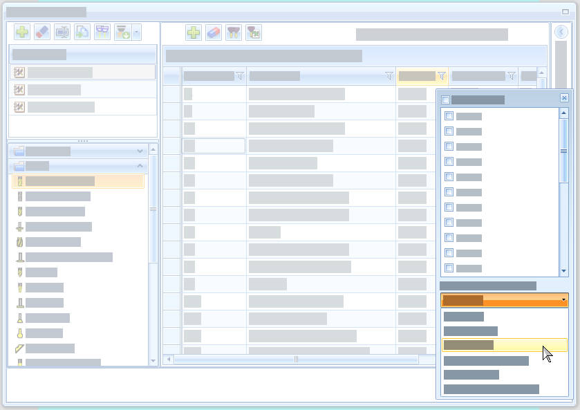

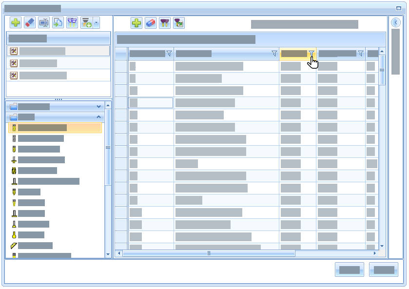

Filtering by Columns
The column information can be used to filter which tools appear in the list. Clicking the
icon on a header opens the filter dialog which then lets you set select which rows to show, based on the rows you select, or the conditions you set. The available conditions can be seen in the table below:
| Show rows with value that | ||
- Hover over the
filter icon in the desired header.
The hand icon appears.

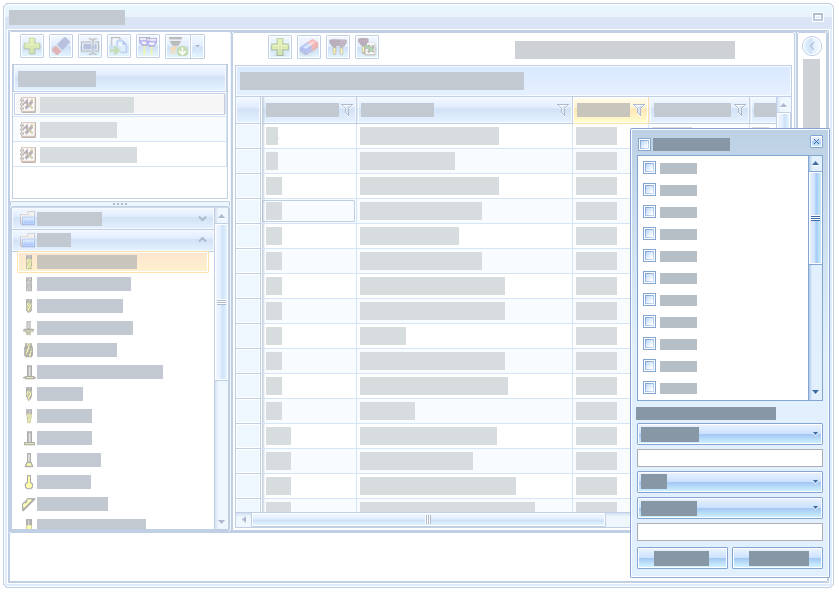

- Click on the
filter icon.
The filter dialog appears.
- Click the first drop down.
- Set the condition to Is less than.
With the value set, the drop down collapses. - Under the first drop down, click in the text field and enter 0.750, and press Enter.
The tool list updates. - Leave the second drop down set to And.
- Set the third drop down to Is greater than.
- Under the third drop down, click in the text field and enter 0.250, and press Enter.
Note: Columns that allow for text, like the Tool Label column have the addition of the
toggle next to the text field. This will allow you to specify whether capitalization matters in your filter. To test this, filter the Tool Label column and set the first condition to Contains and type spot in lowercase. Then turn the
toggle on and off. When the toggle is on, no tool labels containing an uppercase "spot" can be found. When the toggle is off, several tool labels containing the word "spot" can be found.
