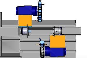

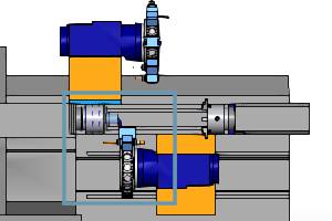

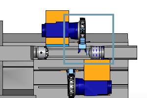

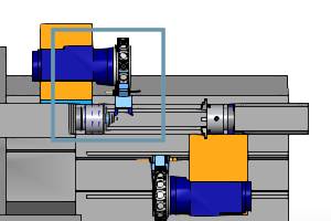

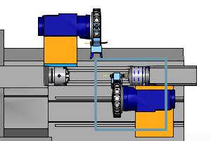

BC 2T 2S Mill Turn Machine
BC 2T 2S Submachine Naming
UT_MS= Upper Turret, Main Spindle
UT_SS= Upper Turret, Sub Spindle
LT_MS= Lower Turret, Main Spindle
LT_SS= Lower Turret, Sub Spindle

Part 11) Create a Part Transfer Using MDI (Manual Data Input)
For Mill Turn jobs, the MDI page of the wizard allows you to manuallydefine machine movements by combining commands to create lines of code. This is used to handle the movement of machine axes that do not have a specific operation, such as part transfers, cutoff/transfer, parts catchers,steady rests, and tailstocks. We define our part transfer after the grooving operation as it is the last operation we perform on the main spindle before transferring the part to the sub spindle. Be sure to have your chuck jaws oriented properly in your machine definition. For more information on the chuck configuration, see The Chuck Configuration topic.
Note: You can create your own generic MDI files (templates) that are customized for your machine to handle transferring the part from the main spindle to the sub spindle. The expected workflow is to define a process once using MDI, save it to a file, then simply load the saved file and change a few values as needed per job. We do the same for this example using the generic part transfer MDI file that is installed with the software. Contact Support for assistance with MDI features: [email protected] / (727) 489-0003
  1. In the CAM Tree, right-click the last Feature Mill Hole-Blind - 0.2500 feature (that we just created), and click Edit.
    The Lathe Wizard displays for you to make changes to the feature.
  2. In the tree on the left, click MDI.
  3. Notice the Save/Loadgroup under the Task List. Click the (Load) button.
    The Open dialog box should display with the correct location already selected: C:\BobCAD-CAM Data\**Current Version**\Features.If not, navigate to this folder.
  4. Click to select GenericPartTransfer.bcmdiand click Open.(Alternatively, you can double-click the file name to open it.)
    The Load MDI Task dialog box displays. This dialog box allows you define exactly what tasks are overwritten with the information from the file. This allows you to load individual tasks from the saved file, but for this example, we use the full replace.
  5. Click OKto replace the entire current Task List with the information storedin the file.
    You can see that only the After Operation task contains any commands(it has the plus sign icon). Click the plus sign to expand the After Operation folder and view all the lines that are already defined. All of our commands are under the After Operation task, because our part transfer happens after the grooving operation.
  6. We don't need to make any changes to our generic MDI parameters, but a few of the important commands that you may adjust per job are listed next.
Important Command Values:
Command
Value
Orient Main Spindle
Angle
Orient Sub Spindle
Angle
Move Sub Spindle to Clearance
Axis
Start Fast Feed Up to Part
Axis and Feedrate
Feed to Pickup Location
Axis and Feedrate
Part Transfer
Part Pickup Position
Send Sub Spindle Home
Work Offset and Axis
Note that the number of parameters that you need to adjust depends on the way you work. Many of these values may never be changed from the values defined in the MDI template file.
Tip: You modify commands on the MDI page using the Parameters group. The general process is as follows:
• Expand a Task to view the Lines under it.
• Expand a Line to view the Commands under it.
• Click to select a Command.
• All available parameters display under Parameters at the bottom of the MDI page.
• Update the values as needed.(The changes you make are reflected in the Task List.)
  1. Click Finish to update the feature with the MDI part transfer.
    Our part transfer is now output in the code, and is also visible in simulation (without MDI, in simulation the part just switches spindles without showing the transfer movement).
  2. Simulate the program to view the part transfer.
