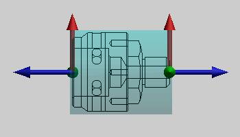

  1. Next we define the machining origin for MachineSetup 1. You can see that the software automatically created bounding entities in the graphics area to assist with the origin selection.
Under Origin, the Pick Origin box is already selected so we can select the origin from geometry in the graphics area.
  1. Click to select the point at the front of the stock.
The origin updates to the selected point.
Modify the Direction of the Machining Origin Axes
Next we modify the direction of the machiningorigin axes to align it to the machine zero (coordinate system). We need the Z-axis to be at the center line or rotation axis of the part to matchthe Z-axis of the machine.
  1. Under Origin,click in the X Axis box, and click to select the vertical edge of the model as shown next.
The X-axis direction of the machining origin updates (shown by the red arrow) based on our geometry selection.
  1. Click in the Z Axis box, and click to select the line on the side of the part.
The Z-axis direction of the machining origin is now parallel to the selected line, but is currently backwards, so next we use the reverse direction button.
  1. Next to Z Axis, click the (reverse) button.
Note: For Mill Turn jobs, you have the freedom to create and orient the part anyway that you like, thus you must orient the machining origin as needed to accommodate your part orientation. An important note here is that the software analyzes the part model in the XZ plane when creating turning features.(The XZ plane is the default, which can be modified during geometry selection.) Also, if you want to use sketches for lathe profiles, create them in the XZ plane of the machining origin to reduce the need to change parameters during geometry selection.(An example is shown next. The red arrow of the gnomon indicates the positiveX-axis direction and the blue arrow indicates the positive Z-axis direction.)
All axes now point in the proper direction for a Mill Turn job, but we want our machining origin to be zeroed at the face of the part and not the stock. Next we adjust the origin location.
Modify the Origin using the Enter Origin Method
  1. Before modifying the origin, we change the viewing orientation. Press Ctrl+1to select the Front view.
  1. Under Origin, clickEnter Origin.
  2. Next to X, click the down arrow one time to change the X-value to 4.000.
Note that we are changing the X-axis value because our machining origin Z-axis is aligned with the X-axis of theWCS (CAD origin). The Enter Origin values are in reference to the WCS.
The machining origin updates to the frontface of the part (instead of the front of the stock). The following image uses the wireframe view to better show the new machining origin location.
