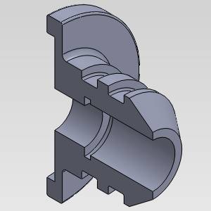

  1. Open the Lathe_Basics_Tutorial.sldpt file.
  2. Click the CAM Tree - Manager tab to access the CAM Tree.
  4. Under Job Type, select Turning select the Start Stock Wizardcheck box, and click (OK)

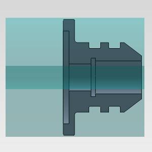

    The Stock Wizard displays.
The first page of the Stock Wizard allows you to define a Workpiece for the Turning Job and the subsequent pages handle shape, size and clearances. In this example, we will not define a Workpiece, but will define the shape, size and clearances for our stock. Once the stock has been defined you can adjust the visibility of the stock.
  2. In the Stock Type page, leave the selection on Cylindrical and click inside of the Stock Coordinate System.
  3. Select Coordinate System 1 from the Flyout Feature Manager Design Tree.
    The Stock is now associated with Coordinate System 1.
  4. In the Size group, type in the following values:
    1. Stock Diameter = 5.125
    2. Internal Diameter = 1.000
    3. Length = 6.000
    4. Stock Origin = 0.125
  5. Click .
  6. Select Coordinate System 1 from the Flyout Feature Manager Design Tree.
    The Machine Setup is now associated with Coordinate System 1.
  7. Leave the Clearance values as they are and click OK to finalize the stock and exit the wizard.

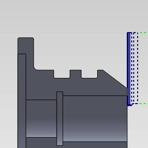

Part 3) Facing the Part
For most every Turning Job, you will need to face off the stock. By selecting a Lathe End Face feature, we will automatically create toolpath up to the machine zero without the need to select geometry. The only time geometry will need to be selected for the Lathe End Face feature is if the desired toolpath needs to end before, or, continue beyond the machine zero.
Add the Feature
  1. In the CAM Tree, right-click Machine Setup - 1 and select Lathe End Face.
    The Lathe End Face feature launches with the Geometry Selection page active. Since our target geometry is already at the machine zero, we do not need to select geometry.
  2. Click Next>> to continue to the Feature page.
Create Feature Extensions
  1. Select the Extension check box and, in the End Distance box, enter a value of 0.1000.
Select a Tool
    The Tool Crib launches.
    The Tool Library launches.
  3. Select tool number 263 to highlight the CNMG - 3/64RAD - ROUGH TURNINGtool.
  4. Click OK to exit the Tool Library and return to the Tool Crib.
  5. Click OK to exit the Tool Crib and return to the Lathe Wizard.
  6. Select Parameters.
Adjust Parameters and Compute
Tip: In this case, we use our roughing tool to rough and finish the face. Since we use the same tool for the rough and finish, the need to create a separate finish operation is avoided by utilizing the Rough Allowance. The Rough Allowance ceases the roughing operation at the values entered and creates an additional semifinish pass up to the Finish Allowance specified next.
  1. In the Finish Allowance group, change both the Z and, X value to 0.0000.

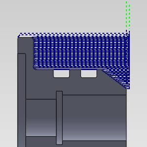

Part 4) Turning the Part
In this step we create a Lathe Turning feature, assign Rough and Basic Finish operations, and define the parameters of those operations.
  1. In the CAM Tree, right-click Machine Setup - 1 and select Lathe Turning.
  2. Click Select Geometry.
    The Lathe Wizard hides and the Selection Manager opens to allow geometry selection.

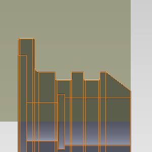

  3. To select the entire model as our geometry:
    1. Select the Select whole bodies check box.
    2. Click on the model in graphics area.
    3. Click OK to confirm the geometry selection and return to the Lathe Wizard.
  1. In the Lathe Wizard, click Next>> to continue to the Feature page.
Adjust Feature Settings
  1. In order to avoid cutting the grooves with these operations, select the Remove Primary Undercut check box in the Undercut group.
  2. To continue beyond the selected geometry, select the check box for Extension and enter a value of 0.2500 into the End Distance box.
  3. Click Next>> to continue to the Machining Strategy page.
Set the Machining Strategy
  1. Select Rough / Finish in the Machining Strategy section of the Machining Strategy page to assign a Rough and Basic Finish operation to the feature.
  2. Select Parameters.
Adjust Parameters
  1. Adjust the Z value of the Finish Allowance to 0.0010.
  4. Select Finish.
Tip: In this case, our stock has already been faced off. In order to avoid unnecessary feed movement, we use the Trim to Stock option to set trim the toolpath to the Operation Stock.
Select a Tooland Compute
  1. Click Tool Crib.
  3. Select tool number 277 to highlight the VNMG - 1/32RAD - FINISH TURNINGtool.
  4. Click OK to return to the Tool Crib.
  5. Click OK to return to the Lathe Wizard.
  6. Click Compute.
Blank Toolpath

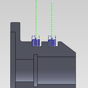

Part 5) Grooving the OD
In this case, we have two grooves that need to be completed on the OD of the part and one groove on the ID. Right now we will focus on the two OD grooves.
    The Lathe Wizard launches.
  3. In the graphics area:
    1. Click on each one of the 5 surfaces comprising a single groove.
    2.  Do this for the other groove as well.
      Both grooves are highlighted.
  1. In the Feature page, under the Constraints section, select From Geometry.
  2. Select Groove.
  3. Click Tool Crib.
    The Tool Library Launches.
  5. Select tool number 281 to highlight the 1/8 WIDE - 1/64RAD - OD GROOVE tool.
  6. Click OK.
  8. Select Patterns.
  2. Select the check box for Rough Allowance and adjust the X value to 0.0050.
  3. Under Semifinish Pattern, set the Overlap value to 0.0050 to ensure that each of the downward semifinish cuts will go slightly beyond center.
  5. Click Compute.

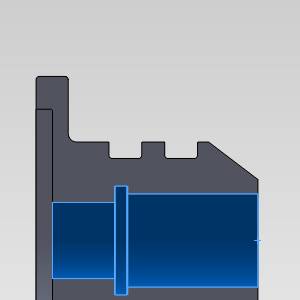

Part 6) Boring the ID

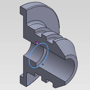

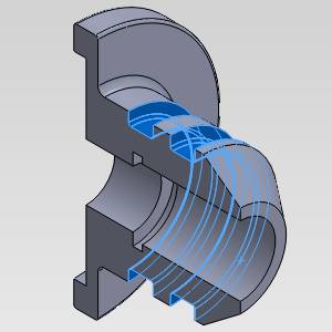

    1. Select each of the ID surfaces of the part, including the three internal groove surfaces.
    2. Press confirm the geometry selection.
Set Feature Settings
  1. In the Feature page under Material Approach, set the Rapid Plane to 0.0500.
  2. Under Feature Parameters, select ID from the Feature Type list to set the orientation of the feature.
  3. Under Undercut, select the Remove Primary Undercut check box so that our rough does not try to complete the ID groove feature.
  4. Select the check box for Extension and enter a value of 0.4500 into the End Distance box.
  5. Select Rough.

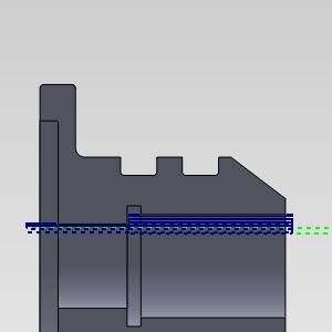

  1. In the Parameters page, select the check box for Rough Allowance and adjust the Z value to 0.0010.
  1. Select Leads.
  2. Click Compute.

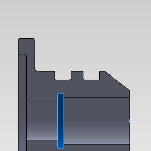

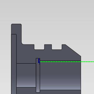

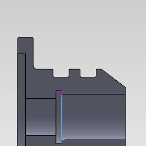

Part 7) Grooving the ID

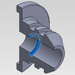

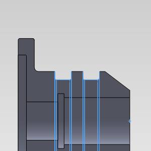

    1. Select each of the three ID groove surfaces of the part.
  1. In the Feature page, under Material Approach, set the Rapid Plane to 0.0500.
  3. Under Constraints, select Custom and then click Pick since the material has already been removed for a portion of this geometry, we can change where the toolpath begins.
  4. Highlight the top edge of the smaller wall of the groove, and left-click.
  5. Confirm the geometry selection.
    The Lathe Wizard returns.
  6. Select Groove.
Select a Tool
  1. Click Tool Crib.
  2. Click GROOVE and then click Add From Tool Library.
  3. Select tool number 280 to highlight the 1/8 WIDE - 1/64RAD - ID GROOVE tool.
    In the Tool Crib:
    2. Click OK.
  5. Select Parameters.
Set Parameters and Compute
  1. Select the check box for Rough Allowance and adjust the X value to 0.0500.
  3. Click Compute.
Blank Toolpath

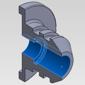

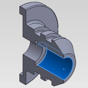

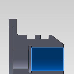

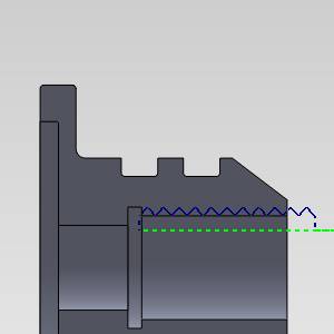

    1. Select the surface of the first internal diameter.
  1. In the Feature page, under Feature Parameters select ID from the Feature Type list.
    1. In the Start Distance box enter a value of 0.3750.
    2. In the End Distance box enter a value of 0.0300.
  3. Select Thread.
  1. Under Parameters, set Threads Per Unit to 5.0000.
  2. Select the check box for Override and set Thread Height to 0.1190.
Important: The Thread Height that is calculated in BobCAD-CAM is the theoretical sharp height. Depending on the thread being cut, you may need to adjust this value.

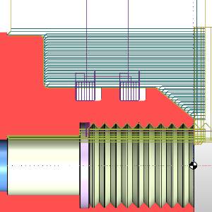

  1. Click Compute.
Blank Toolpath
