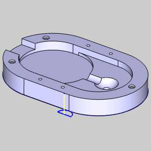

Create a Mill 2 Axis Feature
  1. In the CAM Tree, right-click the Machine Setup - 1 and select Mill 2 Axis.
Feature Geometry Picking

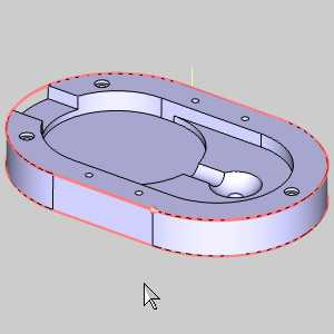

  1. Click Select Geometry.
    The Feature Geometry Picking dialog appears. Focus is automatically placed on the Selected Geometry list allowing you to choose the feature geometry from the graphics area.

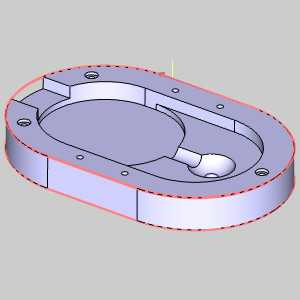

  2. In the graphics area, select the bottom edge of the part.
    The geometry is added to the Selected Geometry list, and the feature preview is visible.

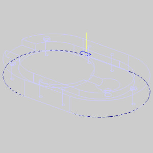

  3. In the Profile Chains list of the Feature Geometry Picking dialog, click Chain-1.
    The chain direction is displayed in the graphics area.
    We will leave our chain in its counter clockwise direction for now.
  4. At the bottom of the Feature Geometry Picking dialog, click in the Pick Bottom list.
    The list is given focus.
  5. In the graphics area, click the bottom edge of the model.
    The snap point is added to the Pick Bottom list, and the Depth is updated.
Note: Clicking the actual snap point that appears is not necessary. When you select an edge to pick a point, the closest snap point is always used.
  1. Click OK.

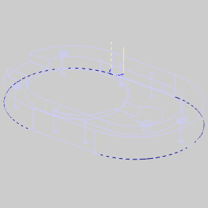

    The toolpath is created.
Warning: When using machine compensation, be sure to use a lead-in and a lead-out. Machine compensation is only called during a linear lead-in motion, and canceled during a linear lead-out. Because of this, it is also important to make sure the lead is large enough to accommodate the tool radius having no compensation at the start, and only fully compensated at the end of the first linear lead move. Since we are using the default tool with a quarter inch radius, this is why we set the radius on our Arc Leads to 0.3000.

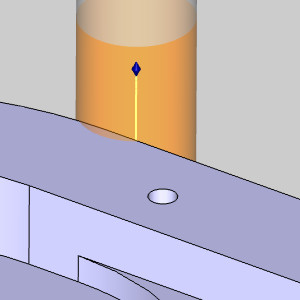

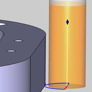

Testing the Initial Position
  1. Since our toolpath is showing the tool position with no compensation, we can backplot the first position to make sure we are avoiding a gouge.
    In the CAM Tree, under Feature 2 Axis, right-click Profile Finish, and select Backplot.
    The Backplot dialog appears.
  2. Click Next twice to move the tool to the Feed Plane, and then to our Total Depth, and zoom in to the tool.
    Notice how the tool is biting into the part. This is because we are using a 0.5000 inch diameter tool, and a 0.2000 inch lead.
  3. In the Backplot dialog, click Close.
    The Backplot dialog closes.

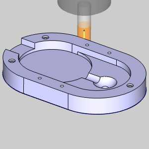

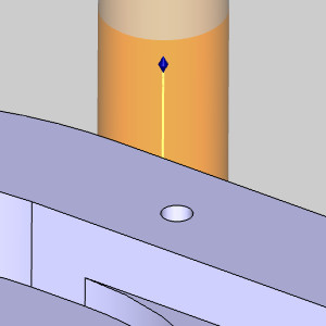

  1. In the CAM Tree, under Feature 2 Axis, right-click Profile Finish, and select Backplot.
  3. Rotate the view to verify the tool position.
    Notice how the tool is set away from the part. This is because we are using a 0.5000 inch diameter tool, and a 0.3000 inch lead.
  4. In the Backplot dialog, click Close.

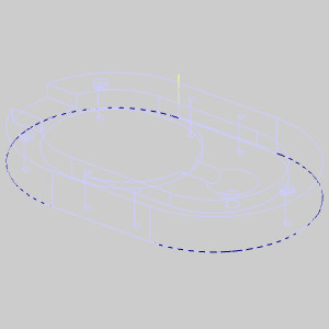

Updating the Chain direction
  1. In the CAM Tree, right-click the Geometry item in our Feature 2 Axis, and select Re/Select.
    The Feature Geometry Picking dialog opens.
  2. In the Profile Chains list, click Chain-1.
    The chain is displayed in the graphics area.
  3. Click the closer side of the part.
    The chain start point moves to the closes snap point.
    Our direction is still counter clockwise.
  4. Click the same area.
    The chain reverses direction.
  5. Click OK.
    The Feature Geometry Picking dialog closes.
  6. In the CAM Tree, right-click Feature 2 Axis and select Compute All Toolpath.
    The toolpath is updated, and we are now using a climb cut.
