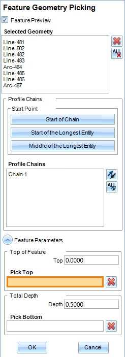

Feature Geometry Picking

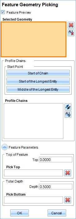

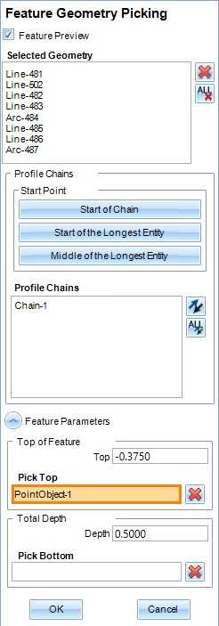

- Click Select Geometry.

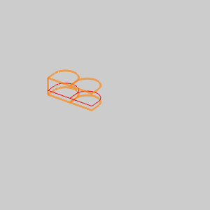

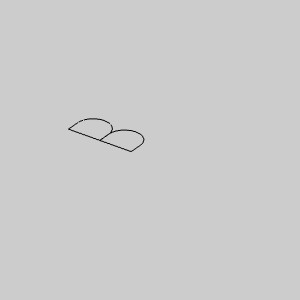

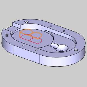

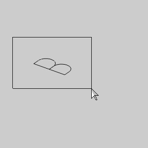

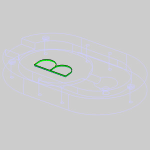

The Feature Geometry Picking dialog appears. Focus is automatically placed on the Selected Geometry list allowing you to choose the feature geometry from the graphics area. - In the Layer Manager, we turn off the layer containing the part so we can easily select the geometry to engrave.
- In the graphics area, window pick the remaining geometry.
The geometry is added to the Selected Geometry list, and the feature preview is visible. - At the bottom of the Feature Geometry Picking dialog, click in the Pick Top list.

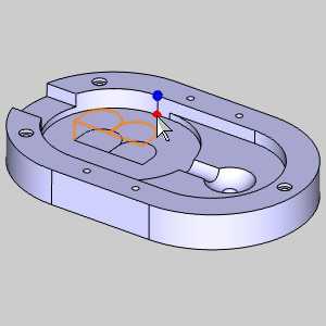

The list is given focus. - In the graphics area, click a snap point level with the surface to be engraved.
The snap point is added to the Pick Bottom list, and the Depth is updated.
- In the Total Depth group, update the Depth to 0.0500.
- Click OK.

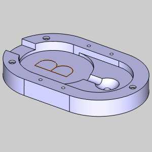

- Click Compute.
The toolpath is created.
By zooming in you will notice the ramp we used to complete our engrave.
